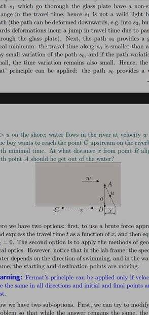

A boy is situated at point A in a river, at distance a from the riverbank. He can swim at speed u or run by at speed v > u on the shore; water flows in the river at velocity w > u. The boy wants to reach the point C upstream on the riverbank with minimal time. At what distance x from point B aligned with point A should he get out of the water?
n1 sin a=n2 sin b
what i tried to do is solve it using the point of reference of w so i get that AB is tilted to the left at an angle a and that CB would be v+w but the solution says it sould be v+w/u and that i should use the formula above to find a and hence find the time but i dont understand why
Is there a diagram that goes with this problem? Use the "Attach files" link below the Edit window to upload the diagram.
i hope this helps
I think I understand the question but can make no sense of your sketched method. Please post all your working. Type it in; images of handwriting are rarely legible.
Without a diagram for reference, I can't tell which way is left.
That can't be right. ##v## has dimensions of velocity, and ##\frac{w}{u}## has no dimensions. So you can't add ##v## to ##\frac{w}{u}## because they don't have the same dimensions. For example, ##v## could have the dimensions of meters per second.
Perhaps you meant ##\frac{v+w}{u}##? But that can't be right because it's dimensionless, and you're looking for an answer that has dimensions of length, for example, meters. Try using LaTeX to write your equations. It will make them much easier for us to read.
I don't think that the equation you have as relevant is applicable here. That's the way to go if there is no current. I assume that the boy's swimming speed u is relative to the water and I note that the current speed w is greater than u. What strategy should the boy employ if he is to get to point C even though the current flows faster than he can swim?

Also, it seems to me that the distance between the banks as well as the distance along the banks between B and C are needed. Are they given?
kuruman said:
What is $$\frac{v+w}{u}$$supposed to be?
Also, it seems to me that the distance between the banks is needed. Is that distance given?
why would it be needed? also $$\frac{v+w}{u}$$ is supposed to be the distance between C and B if we take everything from the perspective of w

you can just click the picture

I believe the boy starts in the river, distance a from the target bank,
There is text missing at each edge.

OK. I see now that he starts in the river. I initially thought that he was on dry land across the river at distance ##a## from the nearest bank. That would have been a more interesting problem.

But, as I said, that can't be right. The problem asks for the distance ##x##, and the quantity ##\frac{v+w}{u}## is not a distance. Likewise, the answer you came up with, ##v+w##, can't be right either because it's a speed, not a distance.
You need to show us how you came up with your answer. Show us all the steps and describe what you're doing. You see examples of what I'm asking for by looking at the worked examples in your textbook. Note that when they work out the solution they show all the steps and explain what they're doing. That's what we're asking you to do. That way we can help you by guiding you towards the right steps to take.
Oh, and one other thing. Don't use the quantity ##a## to refer to an angle. It's already given in the figure as the distance from point A to point B. The distance ##a## will likely have to appear in your answer.
Edit: Now that I look more closely at Post #3 it looks like it is a worked example in your textbook. But of course we can't read the text because you've cropped the text on the left and right sides of the page. Show us the whole thing. I suspect that you are having trouble following the solution given in the textbook. We can help you with that.
