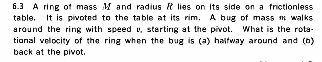

Why when the axis is pivoted, there is no torque in its direction?
All below.
I want to say [the bodies is under gravity field]:
There cannot be torque alonge AB "since it is pivoted"
i think i am missing something.

This question too, since it is pivoted, we could apply conversation of angular momentum about it. Because there is no torque about it.
Although I don't understand this problem, whatever torque that bug is generating while walking around the ring can't be transferred to the table via the pivots; therefore, the ring is free to tilt around the pivots.
