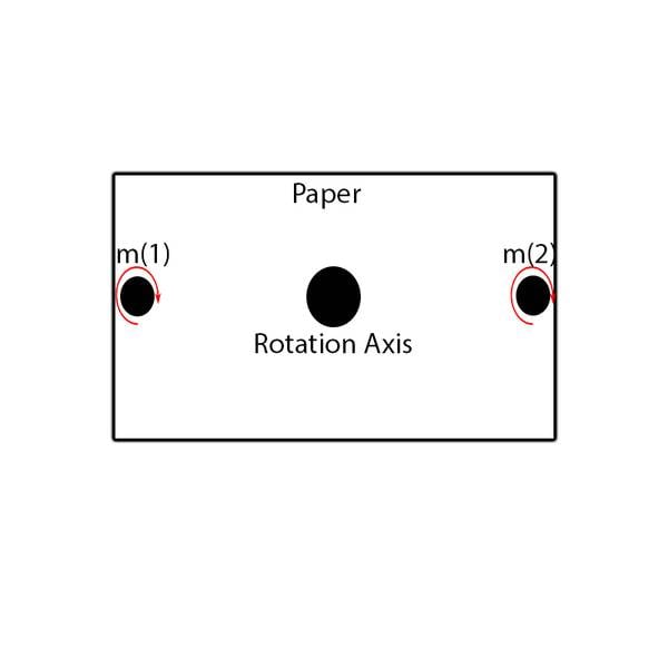

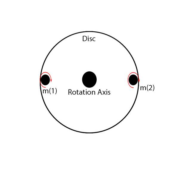

I think the best thing to do is re-state my question using diagrams, and most importantly making it accurate!
So here it goes, still using the same objects a disc and a paper, and instead of my hand I'll place two small motors(attaching it mechanically to the objects) so that it could transfer controlled & calculated torque from the rotor/gear to the object, and the center of the object on a axis of rotation, as diagrammed here:
And:
m(1)/m(2) being the motors.
And I placed the objects within a rotation axis, then powered the motors. The objects should/shouldn't rotate?
My guess is they would not, since the torques are not applied via the rotation axis, also the possibility of the motor's torque being internal force?
You are correct that the system does not rotate, and we did understand it before...so, have you put any thought into the responses you got? Can you draw the rest of the forces into your diagrams?

Well, the motors apply torque on the objects as an action, and an equal an opposite reaction would be an opposite torque on the motor's stator?

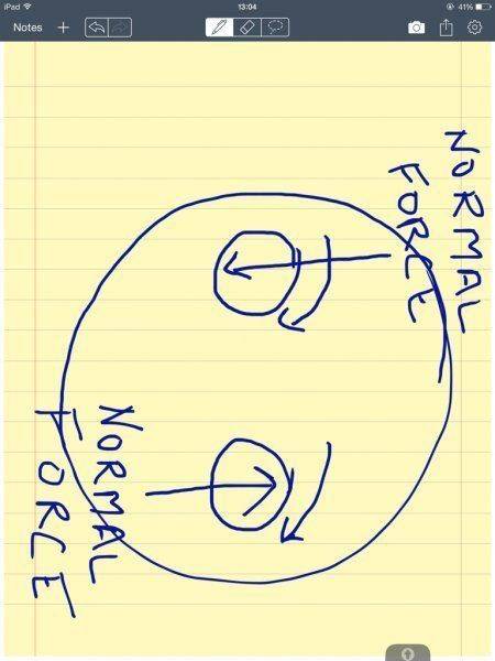

You ARE applying the opposing torque by holding the pencils firmly in place and therefore generating the normal force(see picture)

lawofnature said:
You ARE applying the opposing torque by holding the pencils firmly in place and therefore generating the normal force(see picture)View attachment 81376
What if it we're mechanically attached to it(in any efficient way), the source that is fixing it to place will generate a normal force correct(i.e screw,etc...)?
The act of "fixing" it to the disc will generate a normal force?
Say only one of the pencils attached was rotating and applying torque on the disc. The other pencil, which just stands idle, would then present a physical obstruction to the disc's movement and not let the disc move. It will do it through the use of normal force. This normal force will only exist while the torque is being applied and will only "pressure" the idle pencil (which will be balanced by normal force and balancing torque provided by pencil's base so the pencil doesn't move) until the torque is being applied.
If both the pencils rotate they provide each other's balancing torque through their respective normal forces. Too much torque, assuming there's no slipping, will break the pencils.
