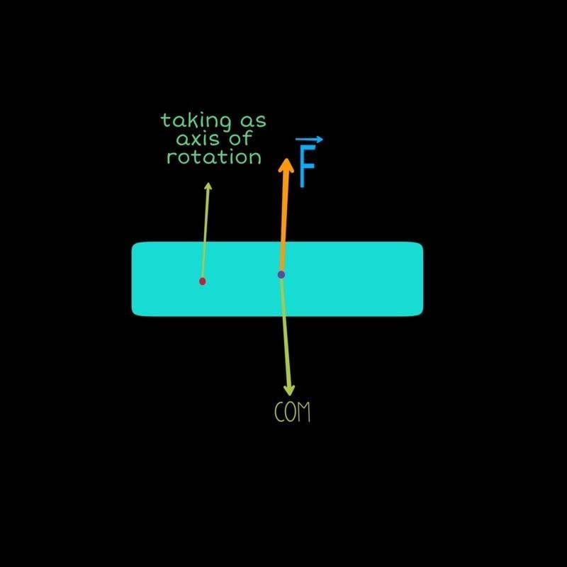

Suppose their is a unhinged rod lying on table and someone applied force at some point then due to it object start rotating.i tried to find why it rotates and came to know that if line of force is not passing through the centre of mass then force will produce torque around the centre of mass and this torque will cause the object to rotate.
Now,
•why do we took centre of mass as Axis of rotation.
- is it's answer is that because it rotates around centre of mass.
So,
•why do object moves around centre of mass?

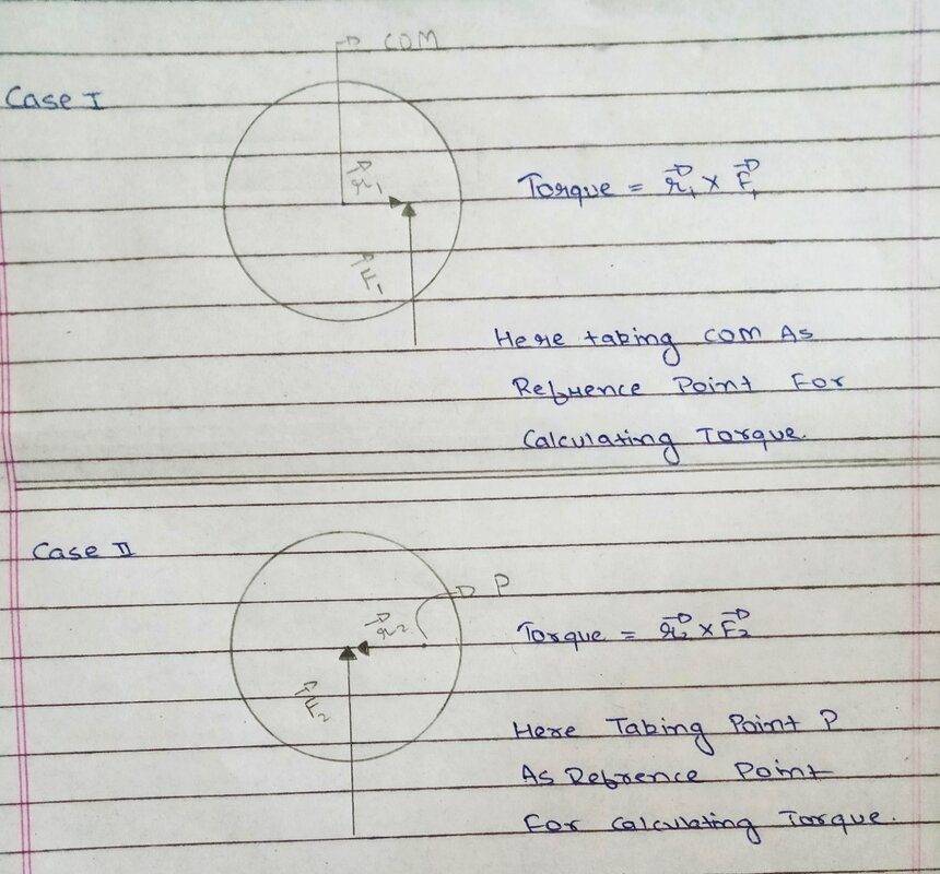

How can we explain this if we take some other point as a reference point and apply force on the center of mass, in that situation, there should be some torque on the object about the reference point we have taken but if we apply force on the center of mass we know it undergoes only rectilinear motion.
If you apply torque, you expect angular momentum to change, right?
But a body that is translating and not rotating about its center of mass does possesses angular momentum about the reference axis you chose.
Thanks,
Please also help me in this query also,
If we apply force at centre of mass and take refrence point same as taken in the photo(posted in post #3)
Then angular momentum will change as velocity is changing and using this equation MVR(angular momentum) we know that angular momentum is changing and if angular momentum is changing then there should be some torque similarly if we take centre of mass as refrence point and apply force on some other point (another than COM) then also both variables M and R can't change but only Velocity can change then why does it rotates rather than just moving in rectilinear path as in case I.

jbriggs444 said:
It does not rotate because you changed the reference point
Here I am talking about the case in which we have applied force on Centre of mass and adopted refrence point as the point on left of the rod.
Q. Why it does not rotate?
Answer:- it does not rotate because you changed the refrence point.
My reasoning:- if we have choosen some other point as refrence point then there should some distance between applied force and refrence point due to which there will be some torque.
if there is torque then there should be change in angular momentum.
Now in both of the cases in which we have i.)applied to force on Centre of mass and adopted point on left as refrence point and ii)applied force on some other point than centre of mass nd taken centre of mass as refrence point what is difference between them as In one case rod is rotating and in another rod is not rotating.

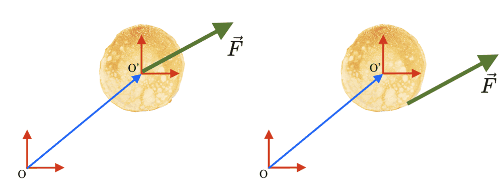

This thread is lacking a good labelled diagram for us all to talk around. Some of the remarks imply that we may well not be talking about the exact same situation.
Everyone has access to a simple drawing (not sketching) utility.
I will try and oblige... I hope you enjoy my illustration of two cases, featuring pancake!
It seems intuitive that a force ##\vec{F}## applied on the upper left would produce a clockwise rotation and that a force ##\vec{F}## applied on the lower right would product a counter-clockwise rotation. It seems perfectly reasonable that the same force applied in the middle would produce no rotation.
Certainly if you apply the mathematics of torque, angular momentum, rotation rate and moment of inertia that the result of "no rotation" comes out of the calculations when a force is applied at the center of mass. It does not even matter what axis you choose to use about which to calculate angular momentum.
sophiecentaur said:
So the applied force F will rotate the pancake in the right hand diagram. The diagram seems to suggest not?? I'm assuming that O and O' are the position of the CM after the same interval of time in each diagram.
My apologies, I should have been more clear. The red arrows are just two sets of coordinate axes corresponding to two different non-rotating (as opposed to body fixed) reference frames. We have ##\vec{r} = \vec{R} + \vec{r}'## if ##\vec{r}## is the position measured in the lab frame, ##\vec{r}'## is the position measured in the CM frame, and ##\vec{R}## is the vector between the origins of the frames.
We have that in the centre of mass frame,$$\vec{\tau} = \vec{r}' \times \vec{F} = I_{cm}\vec{\alpha}$$in the left example ##\vec{r}' = \vec{0}## so the angular acceleration of the rigid body is zero, on the right diagram ##\vec{r}'## is non-zero and ##\vec{\alpha}## will also be non-zero. In both cases, the acceleration of the centre of mass is ##\vec{a}_{cm} = \frac{1}{m}\vec{F}##. We might also note that the acceleration of an arbitrary point on the rigid body at position ##\vec{r}_i## is ##\vec{a}_i = \vec{a}_{cm} + \vec{\omega} \times (\vec{\omega} \times \vec{r}') + \vec{\alpha} \times \vec{r}'##.
If you keep applying a constant force ##\vec{F}## to one particular point on the pancake in the right example, I think it will result in an oscillatory motion :wink:
You are of course correct, it is probably easiest demonstrated with the König theorem. If you don't mind that I refer once again to the pancakes, w.r.t. our lab coordinate system we can write$$\vec{r} \times \vec{F} = d_t \vec{L} = d_t \vec{L}_{cm} + d_t \vec{L}'$$where ##\vec{L}_{cm}## is the angular momentum of the centre of mass, and ##\vec{L}'## that w.r.t. the centre of mass. We can also say$$\vec{L}_{cm} = m\vec{R} \times \vec{v}_{cm} \implies d_t \vec{L}_{cm} = m \left[ d_t \vec{R} \times \vec{v}_{cm} + \vec{R} \times d_t \vec{v}_{cm} \right] = m\vec{R} \times \vec{a}_{cm}$$and that w.r.t. the CM$$\vec{L}' = I_{cm} \vec{\omega} \implies d_t \vec{L}' = I_{cm} \vec{\alpha}$$So back to the original relation$$\vec{r} \times \vec{F} = m\vec{R} \times \vec{a}_{cm} + I_{cm} \vec{\alpha}$$But ##\vec{r} = \vec{r}' + \vec{R}##, so ##\vec{r}\times \vec{F} = \vec{r}' \times \vec{F} + \vec{R} \times \vec{F} = \vec{r}' \times \vec{F} + m \vec{R} \times \vec{a}_{cm}##, so we recover$$\vec{r}' \times \vec{F} = I_{cm}\vec{\alpha}$$which is the same as in our first analysis, and to be expected since the above essentially amounts to "un-deriving" the Konig theorem 😄
In case-I we can see that their is torque about centre of mass and thus it rotates.
In case-II their is torque about point P as we have taken it refrence point and we say that due to torque angular momentum changes as ##\vec V## term in MVR changes but I can't understand why mode of change of angular momentum is different in both cases as in case-I it changes by rotating and in case-II it changes by change in magnitude of velocity.
jbriggs444 said:
It seems intuitive that a force F→ applied on the upper left would produce a clockwise rotation and that a force F→ applied on the lower right would product a counter-clockwise rotation. It seems perfectly reasonable that the same force applied in the middle would produce no rotation.
I also have gut feeling that this would happen but I can't figure out why it rotates.
