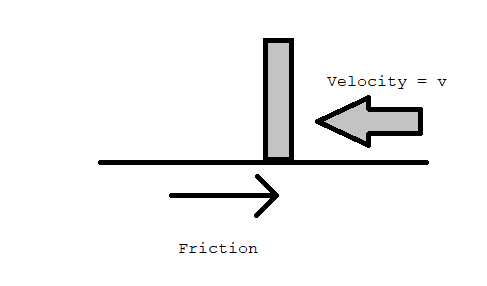

Diagram of a tall rectangular block on a horizontal surface, with a leftward arrow labeled Velocity = v at its right side and a rightward arrow labeled Friction beneath the base.
Not an actual homework problem but a discussion that came up in class while we were learning about torque.
A tall box is sliding across a surface with friction f, mass m, and velocity v. What equations would you use to figure out if the box would tip over while sliding to a stop.
T = Fd
f = (mu) N
I originally was thinking that you could solve this with just torque and force equations but now I'm thinking you would have to use rotational inertia or maybe angular velocity equations. I'm just not sure where to start with it.[/B]
  • Diagram of a tall rectangular block on a horizontal surface, with a leftward arrow labeled Velocity = v at its right side and a rightward arrow labeled Friction beneath the base.

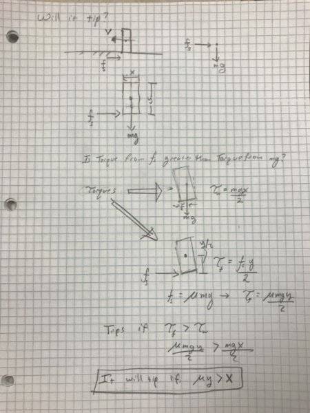

Here is what I came up with but I’m dubious of how valid the solution is since the torques are calculated about different points.
  • Handwritten physics working on grid paper: a box with height y and width x on a surface, friction force f_s and weight mg shown, torque comparison of friction and mg about the edges, concluding it will tip if μ y > x.
Your solution is appropriate the following situation: You push a block of base ##x## and height ##y## with horizontal force ##F## at height ##y/2##. What is the condition for the block to tip before it slides?
Answer: For the the block to tip before it slides, the maximum force of friction must be greater than the pushing force ##F## when the block tips. If we calculate torques about the pivot corner, ##\frac{mgx}{2}-\frac{F_{min}y}{2}=0##. Here ##F_{min}## is the minimum force that will initiate tipping. Now static friction ##f_s## must match ##F## in the horizontal direction otherwise there will be slipping. This means that ##f_s=F_{min}##. Substitute to get the force of static friction at the onset of tipping ##f_s=\frac{mgx}{y}##. That's all you can say. You cannot replace ##f_s## with its maximum value ##\mu_s mg##. That would be the case if you knew that the block is simultaneously on the verge of both tipping and slipping. Furthermore the case has not been made that this problem, with an external pushing force on a stationary block, is equivalent to the original problem of a sliding block that suddenly seizes and stops. I think you should consider conservation of angular momentum between just before and just after the block stops as suggested by @haruspex in #11 and then energy conservation as I suggested in #9. See where that gets you. I must admit I have not tried it, yet.
