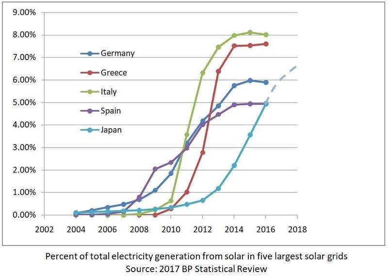

  • #575
Literature indicates solar becomes uneconomic with increasing share of generation, as more installation after a few percent canabalizes the value of existing capacity. More than a decade of data is available now on solar power usage in major countries, which seems to confirm predictions. Apparently solar hits a wall at ~7-8% share of total generation. The five largest countries by installed solar share:
Most of the world is still below 1% solar, so the industry has considerable growth potential, though the data above suggests limits ahead, perhaps lower than these five countries when subsidies are not feasible.
  • #576
What is causing the "wall"? Political resistance? Lack of panel availability? Splitting up the sun between too many cells?
  • #577
Germany and Japan are not particularly sunny countries and population density is high. They don't have huge unpopulated areas, and no deserts.
  • #578
None of the above as far as I can tell. I believe the reason for topping out is simple math, and lack of practical/affordable storage now, or on the horizon.
The panels are only producing a portion of the day (and varies seasonally as well in most areas), with that 8% concentrated into mid-day. So the actual solar power near noon and in-season is a much higher number ( ~ 4 x the 8%? maybe/probably even higher?). Other base load power plants can't be cut back too much, and still be ready for morning and late afternoon peaks, so you can get to the point where the solar power simple cannot be used, and therefore not sold.
Every incremental panel you add at that point is adding to the 'problem', delivering more of its power when it can't be sold, so the economic return on each added panel becomes less and less. There may also be issues of not being able to regulate voltage/frequency of the grid when there is a high % of decentralized power that can't be controlled - but that is beyond my knowledge. There are others here steeped in grid technicalities that could address that.
  • #579
My guess is "storage capacity".
You have to pay REALLY CLOSE ATTENTION to what mhesleps graph is saying.
My guess as to what it is saying; "We've installed solar to the point where it supplies 100% of our needs when it's sunny. We didn't think about storage, so, there is no need to add more, until we solve that problem."
  • #580
I suspect the wall is because of the policies in place for grid attachment.
Net metering and other plans that pay more than the wholesale rate, are accounting dead ends, and will generate push back from the utilities.
The pushback is because they like to stay in business, the response to the utility pushback is often to lower the amount paid for surplus power.
this in turn makes solar less attractive, to the homeowner.
I think solar is strong enough to stand on it's own merit, but they need to sell it correctly.

  • #582
If one thinks about it a bit, the biggest surpluses will be in Spring and Fall when it is still sunny, but not
hot enough or cold enough for AC or Heating.
I think the surpluses could be stored as man made hydrocarbon fuels made at existing refineries.
The efficiency is only about 70%, but the power was going to be wasted anyway.
  • #583
It is mostly availability of the sun and matching the grid demand with the solar supply. In a country like Germany, you get an availability factor of at best 20%, which means 8% of annual consumption corresponds to a peak capacity of 40% of peak load. If the solar production peals at a time when the load is low, there can be a surplus, which has to be wasted or given away for free, providing no economic benefit. This has already happened: enviro-leaning news reports days of 100% renewable supply as glorious harbingers of an all renewable future but In reality they are economic disasters signaling the end of dollar's expansion.
In addition, solar still has to be fully backed up by conventional sources, which means the more solar you put in, the more expensive the backup gets (because it is used less).

  • #586
Germany has been aware of this problem for quite a while, and has considered energy storage as a solution.
https://www.fraunhofer.de/en/press/research-news/2010/04/green-electricity-storage-gas.html
I think natural gas is too cheap to be viable right now, but the technology has advanced and they can now make liquid fuels.

  • #599
NTL2009 said:
And how do you sell solar power at noon, if everyone already has all they can use?
If this lid is real then the short term solutions would be:
- Concentrate on bringing solar power to markets that are not yet near the usage limit.
- Install other forms of clean power. For example, the windiest days tend not to be the sunniest.
- Encourage industry to schedule its most energy intensive activities for when power is most available. This is a basic free market response.
- Restore and improve long distance power distribution. Wind and sunlight very locally, but less so from region to region.
- Continue to improve storage techniques of all kinds.
Note that the first three options here cost nothing beyond what we are already spending, the 4th is needed regardless of whether or not we add renewables, and the fifth is largely driven by cell phones and consumer electronics.
  • #600
