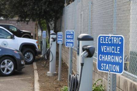

The large majority of the world's vehicle owners don't have two car garages. They increasingly live here:
  • #637
Solution: costs $239
http://www.northerntool.com/shop/to...gSl8AxXMOp358vGbIohl7ZfjbXofVcY4aAo0nEALw_wcB
Also if you park on the street, you probably aren't buying a 2018 model car for a few years. If the city can install street lamps, they can install outlets. And the latter will make them some money so there will be plenty of motivation to do so. I live in the suburbs and all the malls near my house have electric charging stations already.
  • #638
Street lamps are typically 400 W, one or two per block, not 6000 W per parking space.
  • #639
So we are going to fight another gulf war because it's easier than installing a $239 cable? You guys seem really desperate to find obstructions here.

Your cable "solution" is about as viable as all the other "solutions" that have been provided.
A semi truck won't get very far on a 100 foot cable.
Imagine all these EVs, charging at night (so as not to cripple the grid during daytime heavy loads). No solar w/o storage, still need fossil/nukes for low wind nights. Not as simple as a silly cable.
Solar has a place, but it's limited. Best to understand and work within those limitations than to count on unicorns to show up.
  • #641
Now you are just being obtuse. Read context above. Nobody parks a semi outside their apartment at night.

These are not unicorns.
It just occurred to me, if solar generates too much power in the daytime, then install the parking lot plugs where people work, so they can charge in the daytime. Remember that most people drive less then 25 miles a day, so a few cloudy windless days aren't going to be a problem.
These aren't the huge obstacles that some people want them to be.
The ones near my two malls are nicer then the pic above. You'd never notice them if you weren't looking.

Algr said:
These are not unicorns. View attachment 211175 It just occurred to me, if solar generates too much power in the daytime, then install the parking lot plugs where people work, so they can charge in the daytime. Remember that most people drive less then 25 miles a day, so a few cloudy windless days aren't going to be a problem. ...
OK, that could help.
But some people aren't going to be too happy to expect a charge, and then it turns cloudy with no excess that day. I suppose we could have smart algorithms in cars, and people could say "charge my car only if there is excess solar, at the discount rate", or "charge me a minimum of XX kWh, regardless of excess". People with commutes that are short relative to their range, and with the option to plug in at home to charge at night could take advantage of the excess when it is available.
So how 'bout running some numbers on that? I often find when I do that, it doesn't work out as well as I hoped. Maybe this one is different?
