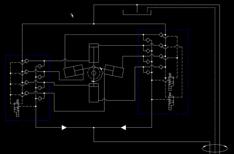

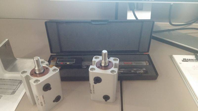

This is where we exploit the advantages of pressurized fluid as a power transmission medium. Converting rotary motion directly to psi/in2 energy units and converting it again to rotary motion of a much higher velocity with low energy losses. With electrical/mechanical component combinations doing this is very expensive.
Attached is a picture of the small actuators I will use for the radial pump located at the turbine head. Except the ones shown in the photo are 1" stroke, I will use 3" stroke cylinders for the "pump" in the configuration shown in the cut-away model pic. Each cylinder is $151.50/ea retail.
The cylinders can be turned off individually and allowed to float so that turbine can continue turn and produce energy at low wind speeds. This energy is stored in an accumulator until saturated, then released to the hydraulic generator motor.

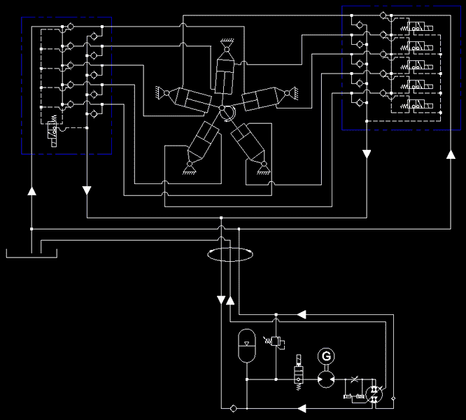

Here is an updated, complete schematic of the concept system. Very compact, simple, efficient, and cost-effective transfer of energy directly to a 60Hz 240VAC generator. And completely scalable.

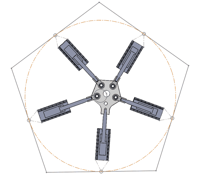

After looking at other radial piston designs I've opted for a 5 cylinder pump system. Again, each cylinder is able to be turned off and allowed to float so that the lightest wind can keep the turbine rotating.
One of the reasons I'm sharing this is because I believe fluid power systems are being overlooked in the renewable energy industry. And there are a lot of applications, such as in wind turbines, that such systems are very well suited. This thread is also being shared on Reddit.

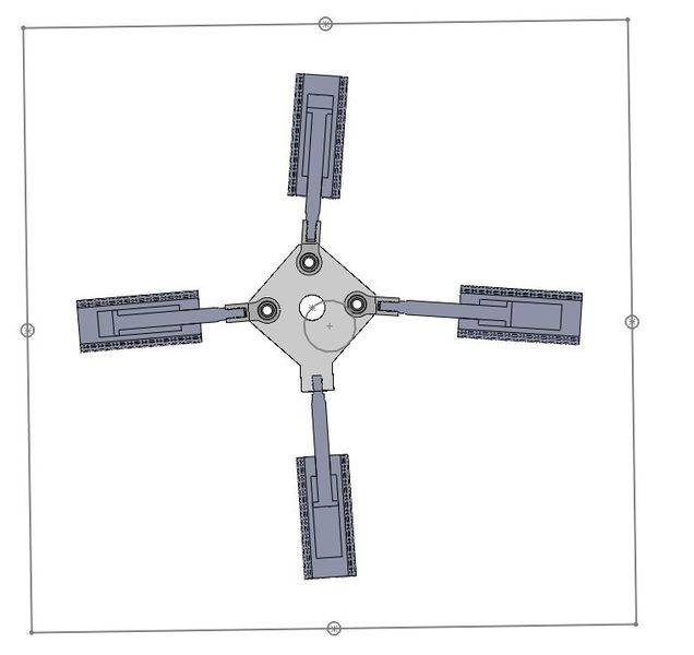

I am by no means an expert on fluid dynamics and pump design so I do have a question about this design. Wouldn't an under square piston configuration with a 3" stroke require pivoting on each individual pump case to reduce side loading on the piston? Would an over square pump with a large bore and a wrist pin on the piston simplify construction in a radial configuration? Are off-the-shelf components in these dimensions readily available?
It would also depend on the torque requirement and form factor to suit it's location. So many factors to take into account.
To be honest, I don't know the terms "under-square" and "over-square" in this context but I think I'm following you...
The cylinders would have a pivoting mount where they attach to the outer frame.
One of the cylinder rods has to be fixed to the center lug that the rest of the cylinders are attached and be able to handle side loading. That particular cylinder may simply be a ram with no annulus or an oversized rod in order to be stout enough.
Yes, I'm looking at this as something that one could build themselves from common off-the-shelf components but scalable to industrial sizes.

An updated model of the radial cylinder configuration:

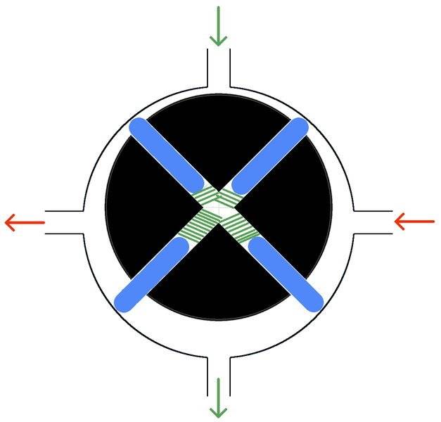

And I called to mind a discussion about 48 or 50 years ago, when a then colleague in IBM, one James Philbrick (very intelligently creative, but since deceased, I am very sorry to say) described an invention that I admired. I know that he patented it in the same or following year, but I never saw that anyone took it up. I mention it here, as nearly as I remember it, in case anyone can put it to constructive use. Alternatively, if anyone happens to know that it is currently in use, I would be curious to know. Otherwise it would be a pity to waste it, I reckon.
James had been a hydraulics engineer with experience in designing systems for ships, and had recognised that a generalisation of the rotary vane pump could be used to power one flow of liquid by the input of another flow. By shifting the axis of rotation of the rotor, one could smoothly in effect change gear, either moving more fluid against lower resistance, or less fluid against higher resistance. I include a sketch of what I can remember from my distant youth. I omit the notional mechanism for moving the axis of the rotor (James represented it at the time simply as an external lever of type two, with the rotor axis in the middle).
The power is applied by one pair of opposed inlet-outlet channels (say the green arrows) which drives fluid through the other pair according to the position of the rotor in the outer drum. No doubt an arbitrary set of input-output channels could be combined for more complex requirements.
For your attention for what it is worth.
I apologise, but I failed to insert the diagram in usable form. In case my description fails to convey anything articulate (very likely!) I have posted it at:
https://www.facebook.com/photo.php?...5908628.111317.100001576411737&type=3&theater
Good luck to anyone interested.
If anyone could tell me how to include the image more conveniently, feel welcome.
