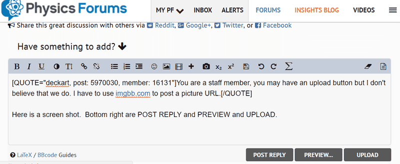

First, save the image on your own PC. Then use the UPLOAD button to insert it into a post.
You are a staff member, you may have an upload button but I don't believe that we do. I have to use imgbb.com to post a picture URL.
Here is a screen shot. Bottom right are buttons labeled POST REPLY and PREVIEW and UPLOAD. After it is uploaded, new buttona appear. Position the cursor to where you want to insert it and click FULL SCREEN. Note that this works with pictures stored on your PC (JPG, BMP, PNG, GIF, ...) , not a URL.
That's why we couldn't see it, it was right in front of us. :)

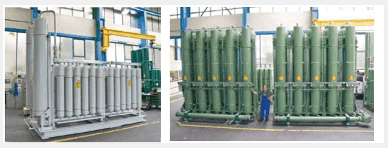

What would these accumulators physically look like? I assume these are oil pumped into a chamber with air/gas, so the energy storage mechanism is compressed gas?
I was under the impression there is a fair amount of loss in a system like that. Compressing a gas heats it, and that heat is lost over time, which could be many hours if you are trying to smooth wind differences over the course of the day.
How large would accumulators be per MW-Hr of storage?
deckart; You show accumulators that have a reciprocal pressure:volume relationship. The compression of a gas in the accumulator will lead to thermodynamic inefficiency. The changing pressure, while operating over the energy storage range, will make it more difficult to optimise the efficiency of the hydraulic pumps and the generator motor.
When a system is operated at a constant pressure, it can use a pumped water reservoir with a reasonably stable operating pressure due to the fixed head. There is a parallel here with the fixed voltage of the electricity grid and distribution system.
One requirement of an accumulator is the need for a greater working volume of fluid, plus a companion reservoir with an equal fluid capacity. If water is the low cost environmentally friendly fluid employed for the storage of potential energy, then there needs to be a reservoir low pressure "tank" at the altitude of the wind farm pumps, with a significantly higher altitude “accumulator” lake. Those fluid storage lakes should preferably have very large surface areas so as to minimise pressure variation with energy stored, and to minimise disturbance to the natural environment.
An underground water reservoir, or a fabric bag held deep underwater, will have the same hydrostatic pressure change in the connection line to the deep storage as the storage itself. That will make energy storage impossible unless a lower density coupling fluid such as compressed air is used. That comes with the thermodynamic inefficiency of the gas compression and expansion cycles.
Here is an example of what an accumulator stand might look like for a large wind-turbine station:
Thermal losses are determined by the rate of charge and discharge. A system sized for slow charge and discharge will mitigate the impact of thermal losses. Inefficiency will depend on how the accumulators are used. This is the difference between an isothermal and adiabatic application of an accumulator.
(Actually, I'm wrong on this. Heat is generated regardless of rate. A solution, the accumulator cylinders need to be insulated so that the heat energy is kept in the system and the accumulator pre-charge and size would have to reflect the heat-induced gas expansion.)

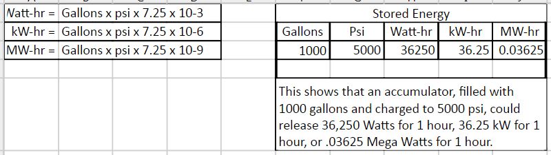

"The primary cause of capacitance in a hydropneumatic accumulator is compressibility of the gas. The behavior of the gas can be approximated with the ideal gas laws under isothermal (constant temperature) or adiabatic (no heat energy enters or leaves the system) conditions." Source: http://www.hydraulicspneumatics.com...tors/Article/False/7225/TechZone-Accumulators -Jack L. Johnson, P. E.
Considering we are storing energy that would otherwise not be generated by the wind-turbine and stored at all, this is a great application for energy storage for use later in a more scheduled fashion.
I will crunch some numbers on what the MW-Hr storage capacity could look like.

I estimate that the accumulator bank illustration with the man standing in it is approximately 1000 gallons.
I contacted a friend who has had to make these calculations before in his consulting work. This is what he sent me:
One complete charge would power the average US home for more than 3 years. This seems considerable but I'm not sure what percentage of a towers capacity factor (avg is 25% of rating) would be useful for day-to-day use. The "capacity factor" is the average output relative to a wind-turbines rating.

I estimate that the accumulator bank illustration with the man standing in it is approximately 1000 gallons. ...
[ chart shows 36.25 kW-hr]
One complete charge would power the average US home for more than 3 years. ...
Please check your (and my) math.

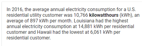

Google says:
In 2016, the average annual electricity consumption for a U.S. residential utility customer was 10,766 kilowatthours (kWh), an average of 897 kWh per month.
That is ~ 30 kW-hr per day, so that 1000 gallons would power the average US home for a little more than 3 years one day ( ~ 28.8 hours).
edit/add: I realize now you are likely off by a factor of 1000 (KW versus MW or W), as three years is ~ 1000 days.

Google says:That is ~ 30 kW-hr per day, so that 1000 gallons would power the average US home for a little more than 3 years one day ( ~ 28.8 hours).
Got it! I was just looking at Watts. This wouldn't work in that capacity at all!
