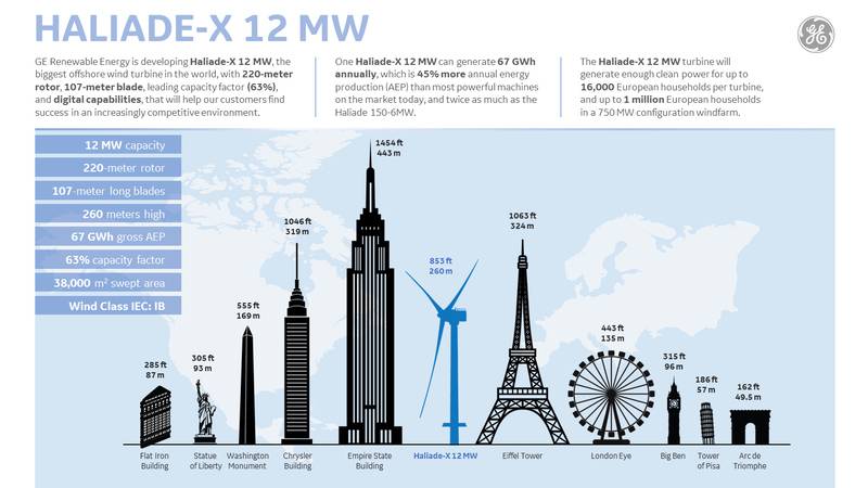

I think you will find that blade length is more important than number of blades.
The newest wind turbines on Earth are scaling up from 3 MW each to 12 MW, and from 300 ft (100m) to 863 ft (260m) in height; but still 3 blades.
On Mars, they could be even higher.
https://www.windpoweroffshore.com/article/1458364/ge-unveils-12mw-offshore-turbine-updated
