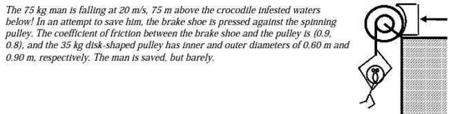

Well, I tried working on this problems a few different ways and kept hitting a dead end. The work in "relevant equations" was my last attempt. I have spent well over an hour on this problem and I am ridiculously frustrated.
Our professor never covered this type of problem in our course and I just can't seem to figure it out on my own. I found the force of the rope the man is holding onto to be 935N, which I am almost certain is right. However, I am not sure how to go about solving work-energy for the pulley. I don't know how to incorporate torque forces into the work-energy equation. If someone could help point me in the right direction, I would greatly appreciate it.

Oh, sorry. Yes, the answer in the back of the book is for the force the brake applies to the spinning pulley. Also, yes to the two methods getting me a bit confused.
What I did first was used work-energy to find out how much force the rope attached to the man must have applied in order to stop him at the 75m mark. The value I got for that was 935N. However, when it came to solving work-energy for the pulley, that is where I got lost. I wasn't sure how to analyze the two forces (friction and force of rope attached to man) in the work-energy equation. I figured torque should be considered since the amount of force would be dependent on the distance from the center of the pulley, but I am not sure on that one. I really am completely lost on it.
