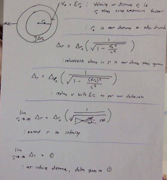

I know that space is expanding, so the further away you go from my location, the faster space is expanding, asymptomatically approaching the speed of light. I also know that as relative velocities approach the speed of light, the length of space contracts. From this I come up with a limit for the diameter of the universe, relative only to the rate of expansion and the universe's age. Is this a correct way to look at the universe on the grandest scale or am I missing something important?

I'n not following, I assumed an infinite universe. I wrote out my math and hopefully you can explain what I did wrong. I'm pretty sure that the math is correct, I'm sure it's my understanding of relativity.
I imagine a universe where I can describe things around my as a sphere with radius r. No matter how far away I go, I can always go further. The difference between distance 1 and distance 2 is the delta. Here is my math: step by step.
1) The diagram shows a circle with radius r and a second circle with radius r0 + delta r0. The velocity of objects moving away from us at that location is defined by r0 times some scalar factor (E), it's exact value makes no difference as long as it's positive.
2) r0 is the REST distance to the edge
3) Δr (relativistic) is Δr0 times γ.
4) Replace the v variable of γ with the formula for finding v0 from r0.
5) Take the limit of the function as r approaches infinite.
6) I got a Δr of 0, meaning at the sphere defined with radius of infinity has a limit to it's size.
Wouldn't this imply that two galaxies really really far away from us (billions of light years) but one is millions of light years further than the other, from our perspective are essentially flatten paper thin and basically on top of each other?
This is wrong; you can't apply special relativistic formulas to the universe as a whole. Those formulas only work in flat spacetime, and the spacetime of the universe as a whole is not flat. The "recession velocities" that cosmologists talk about are not special relativistic "relative velocities", and their kinematics don't work the way SR velocity kinematics work.

Thanks, I'm reading the paper now and I understand it well enough to understand why my calculations were wrong.
