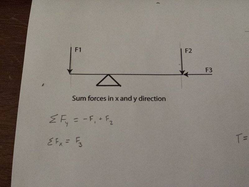

Being asked for the sum of forces in the X and Y directions and the axis are set up 'normally' so like a plus sign ( + ).
I attempted the first one and I think I did it correctly, but I'm not so sure about the second one.

The first one is fine. Where's your work on the second one?

So I was looking through my notes, and I saw the equation Vx = Vcosθ and Vy = Vsinθ.
I'm not sure though that this is where i can put these equations to use, since i don't know the value of V. In looking at the angles, F1 is 60° from the x-axis going counterclockwise. I'm lost in more of how to put the information I do know together.

That's how you'd find the x and y components of some vector V, where θ is the angle made with the +x axis.
According to the diagram, it would be F1.
F1 is 60° below the negative x axis. So will the x-component of F1 be negative or positive?
If the x-component is below the negative x-axis i would think that that component would be negative. But using those equations I think I've determined the answer.
F1x=F1cos60°
F1y=F1sin30°
I broke this down by drawing out the picture of the triangle somewhat given and by finding the f1x and f1y components and plugging those into the equations I had.

Looks OK except for the signs.
In question with the signs, would the x-component be negative because it is technically below the F1 and the y-component positive because it is technically above the F1?
Hint: Redraw the vector F1 so its tail is at the point of application. Or at least imagine a set of axes with the origin at the tail of F1. That will make it easier to see the signs of the components.
The x-component of F1 is negative since F1 points to the left of the vertical axis.
The y-component of F1 is negative since F1 points below the horizontal axis.
