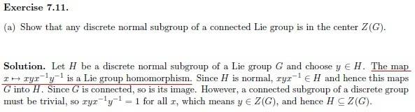

Hi! I was just going through this script on Lie groups: http://www.mit.edu/~ssam/repthy.pdf
At one point the following is said:
(see attachment)
I've spent multiple hours trying to figure out why this is a group homomorphism. Sure, once you know the theorem is correct, this follows. But without knowing this, I can't figure out why it should be.
I want to see that:
[itex]\varphi_y(x_1x_2) = \varphi_y(x_1)\varphi_y(x_2) \Leftrightarrow x_1x_2yx_2^{-1}x_1^{-1}y^{-1} = x_1yx_1^{-1}y^{-1}x_2yx_2^{-1}y^{-1}[/itex]
If I write [itex]x_1y = \bar y_1x_1, x_2y = \bar y_2x_2[/itex], then the above equation is equivalent to
[itex]x_1\bar y_2x_1^{-1} = \bar y_1y^{-1}\bar y_2[/itex]
but I don't get any further from here.
Anyways, I think whether or not this is a homomorphism is not necessary for this proof. One can just argue that this map is smooth since G is a Lie group, therefore the image under G is connected, therefore it is a one point set and since eye-1y-1 = e one gets that this set must be exactly {e}.
I agree with you: I can't either see how that map is a homomorphism in a general case, but it is unnecessary to consider it that way.
