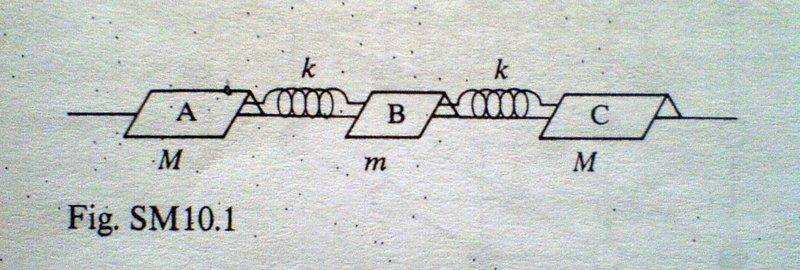

A model of the carbon dioxide (CO2) molecule is constructed as shown in Fig. SM10.1
Two sliders A and C, each of mass M, represent the oxygen atoms and are connected by light springs, of force constant k, to a slider B of mass m, representing the carbon atom. All three sliders are placed on a linear air track. The two important modes of oscillation along the axis of the model molecule are as follows:
Mode 1: B remains stationary, and A and C oscillate so that the centre of mass of the model molecule remains stationary
Mode 2: A and C move equal distances in one direction, and B moves in the opposite direction in such a way that the centre of mass again remains stationary.
Show that the frequency f of mode 2 is given by [tex]f = (1/2\pi) [(k/M) + (2k/m)]^{1/2}[/tex]

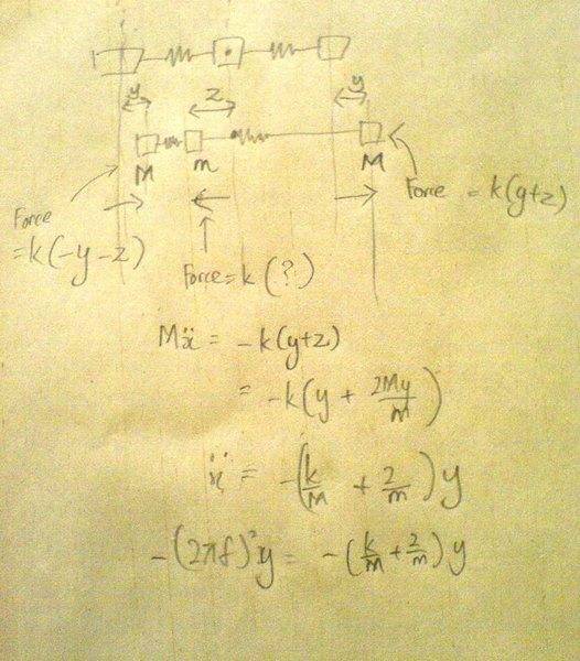

[tex]\text{In\ equilibrium,} zm = M (2y)[/tex]
I came to me that the centre of mass of the system should remain unchanged throughout the motion, but how exactly do I justify the statement? Can I say "because there is no net force acting on the system, the centre of mass remains the same throughout the motion"?
Also, I am able to obtain the about equation f if I consider the motion in C. Could someone please show me how to obtain the same equation using B?
Can anybody explain to me how
in equilibrium, [tex]zm = M (2y)[/tex]
actually came about?
Thank you!

Since there is no external force acting on the body, the momentum is conserved. Simply use momentum conservation law on the A-B-C system.

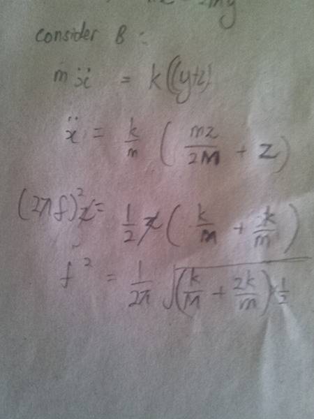

Using the same idea you did in your attempt, you should be able to find the force on B due to the spring. The frequency of B will of course be the same as that of A and C. What would be the force on B? How can you relate this force to the differential equation for SHM?
Taking moment from the left.
New moment of A,C (move to right)=MAy + MCy
To maintain equilibrium mB has to move to the left in equal moment.
mz=2My
By considering the forces acting on B by masses A and B, I am able to come up with the formula F=k(y+z). However by doing that I am ignoring the forces on the right, and that the formula I obtained at the end is divided by a factor of surd 2. What am I doing wrong over here?
Can somebody please show me a partial solution for this one? I gave been really busy and I'm WAAAAY behind my schedule. Thank you...!
You have made a mistake taking the force on B. Its not [itex]k(y+z)[/itex] but instead, [itex]2k(y+z)[/itex]
