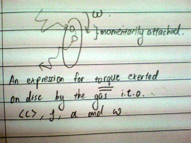

Derive an expression for the number of impact of gas molecules on unit area in unit time in terms of the number of molecules per unit volume, n, and their mean speed, <c>. Explain the assumptions you make.
A disc of radius "a" rotates with constant angular velocity "omega" in a gas at low pressure so that the molecules of the gas strike the disc from random directions. If the molecules are momentarily attached to the disc and leave in random directions relative to the disc, derive an expression for the torque exerted on the disc by the gas in terms of <c>, the mean speed of the gas molecules, rho, the density of gas, "a" and omega.

In the second part of the question, the molecules will strike both sides of the disc with random speeds c. When they leave the disc, they will have a systematic velocity v superimposed on c due to the motion of the disc. The momentum given to each molecule will cause a dragging effect on the disc. The drag on a molecule that strikes the disc between radii r and r + δr is mωr (hence drag increases with increasing radius). Remembering that there are two sides to the disc, the total number of molecules striking this annulus in unit time is [tex]2 \times 2\pi r \delta r \times n<c>/4[/tex]. The torque due to this annulus is the moment of this force about the centre of the disc, so the total torque involves an integral of the form [tex]\displaystyle\int kx^3 dx[/tex].
This is AWESOME! I would have never thought of something like this. But what I don't get is the part
and
. And why do we have to integrate [tex]\displaystyle\int kx^3 dx[/tex]?
