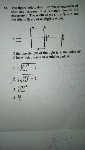

1. The problem statement, all variables and given/known da
Interference minima is asinΘ=nλ/2 where n=1,3,5,7...
[/B]
Putting ab/(2sqrt(b^2/4+d^2))=λ/2 for first order minima
And solving for d I get (b/2)*sqrt((2a/λ)^2-1) in which only the 2 factor differs in front of a in the square root
from the correct ans which is option 2 in the question
I may be wrong but where I didn't get it?
Why did you start with the condition for interference minima? The passage of light through the first slit is diffraction.
ehild said:
Check the formula in red.
yes I have used this formula
