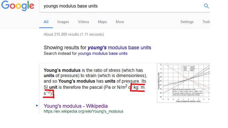

Check the units of Young's modulus.
I checked the units in your equation, and they look OK to me.
The equation in post 1 ("Relevant equations") has matching units. The calculation in post 3 has a mistake.
Yeah, I was taking the value of the Young's from google which seems to be incorrect. It should be kg.m^-1.s^-2
