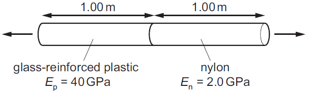

A rod is made up as shown [pic attached]
Diagram of a rod made of two joined sections, each 1.00 m long: glass-reinforced plastic with Ep = 40 GPa on the left and nylon with En = 2.0 GPa on the right, with tensile forces pulling outward at both ends.
Both have same cross-sectional area. Ep and En are Young modulus.
The rod breaks when total extension = 3.0mm
Greatest tensile stress that can be applied before rod breaks?
Young modulus = stress / strain
Ans: 5.7 x 10^6 Pa.
Won't it break when the one of the 2 materials breaks? Can you please tell me the concepts to be used. How to solve?

The Young's modulus tells you how much the material stretches for a given applied tensile stress.
If you apply the same stress to the rod shown in the OP, which material is going to stretch more?
The problem is asking you to find how much stress can be applied to the rod so that the combined stretch of the nylon and the glass-reinforced plastic equals 3 mm. Remember, the strain is equal to the change in length of the material divided by the original length (unstretched).
Sure, but you don't care which breaks, or even the fact that it breaks. What matters is that the max allowed extension of the rod as a whole is 3mm.
