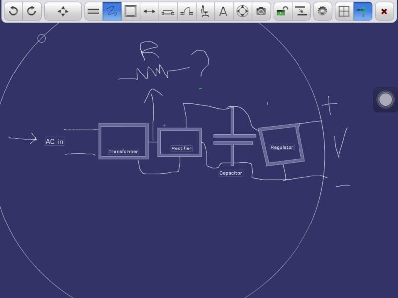

Hi, I have to build a very basic power supply, basically from a 220V AC Wall socket to a certain DC Voltage as the output. I plan on using a transformer, rectifier,capacitor and a voltage regulator. I can see that following this design it can only give out one value of voltage. I thought of inserting a potentiometer so that if the transformer gives out 24V AC i can adjust the output voltage with values from 0-24V which would run almost all DC devices.
My question is, can i just place the pot between the transformer and the rectifier? Or maybe its better if its placed after the regulator? Will there be a difference if the pot is placed in different places since all that is being done with the signal is conversion?
All I have is my tablet right now so here's a pretty rough sketch
I know it's very basic and all, i just wanted to clear things out as much as possible before i get to working on it

You will have to consider how much power dissipation you will have in the potentiometer.

You can get voltage regulators which are variable output types.
These have a pot in the circuit which is used to adjust the voltage
One of these is the LM317K but there are others.

If you follow a variable voltage control with a regulator (as in the diagram) the regulator will do its best to nullify any change in voltage (until the volts become too low, when the regulator will be turned 'hard on'). The more elegant way would be to use a variable regulator, for which there are many circuit designs.

Your sketch omits some important things if you are going to be connecting to 230Vrms. Notice that there is a fuse in post #3? What other things must you do when connecting to 230Vrms?
What experience do you have so far in dealing with high voltages?

If the supply is unregulated, then putting a pot in the circuit will vary the output voltage, but the voltage will vary with load current.
Putting in a regulator, as in post #3 above, will still give you good control, but the voltage will not depend on the load current.
The regulator circuit has a pot shown as R3 in the diagram. This varies the output voltage.
You should also look for a regulator circuit which lets you set a current limit. This would mean you can short circuit the output accidentally and not destroy the power supply or blow a fuse.
Safety. You should find out and correctly apply the wiring regulations that are applicable to your country.
In my country, it is not legal for anyone except a licensed electical worker to wire the mains voltage side of any equipment. This includes replacing a damaged plug or cable.
