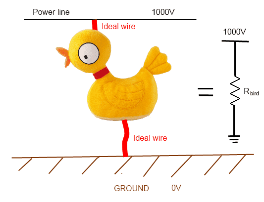

Quote Quote by Fjolvar View Post
I read somewhere that if the bird is grounded then it will be electrocuted, but I don't understand.. does the ground create some potential within the bird itself?
There's a potential difference between the wire and ground regardless of the bird, but when you connect a conducting bird between the two, that entire potential will be across the bird. The bird provides a current path with whatever resistance the bird can muster. OK I just realized I picked a rubber duck. I'm not very good at this, sorry.

Fjolvar
#11
Feb5-13, 11:01 AM
P: 140
Quote Quote by gnurf View Post
Thanks for the illustration! So just to clarify, when current is traveling it will choose the path of least resistance, but if there are two paths (through the bird which is grounded or continuing through the original wire) it will flow through the bird because the ground potential is present on the other side. So current always wants to make it to the ground potential even if it has to flow through some higher resistance to get there despite there being an immediate lesser resistive path such as the wire transmitting power?
So just to clarify, when current is traveling it will choose the path of least resistance, ...
No, that statement is simply wrong. The current will always! choose all available paths. And the current through each path is always! V/R. Now V may drop if the load is too high but that won't happen in this case.
