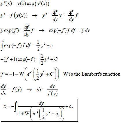

I thought today of the next DE:
[tex]y''(x) = y(x)e^{y'(x)}[/tex]
Not sure if it has applications, obviosuly I tried to find a solution via power series around x=0.

Hi !
The ODE is solvable on the form of the inverse function x(y) as a special function defined by an integral :
