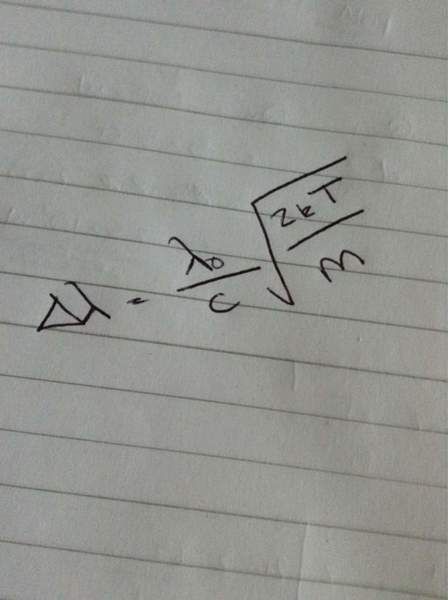

I had this question given in my class
A spectral line from iron (mass 55.934 amu) atoms in the sun is measured as 637.4 nm. It's width is measured to be 0.053 nm. Calculate the temperature of the sun?Now I done this using a formulae I was given but it yielded an answer no where near 5778K
Above is the equation I actually used where delta lambda is width and lambda 0 is wavelength? I'm confused as to why my answer is two orders of magnitude out? Is it supposed to be like this as the iron atoms will be hotter because of the chemical composition or am I supposed to be able to get roughly 6000K with this question? I know there is little iron compared to hydrogen and helium in the sun so could that have something to do with it? So many questions
Anyways thanks for your help in advanced I hope you can help

Well
λo= 0.053 nm
λ= 637.4 nm
k= 1.38*10-23Mass I had 55.943 amu but I converted it into kilograms and got
m= 9.28*10-26 kgAnd it was using these numbers I solved the equation
First I took the fraction of λ/c across, then I simple squared both sides and solved for T

That looks good.
What does that give you?
I also get a very strange result using the given data.
Yea it's odd my thinking was maybe there is a reason it's so high and we have to notice it

KiNGGeexD, I think you've wrongly defined some of the parameters. The original equation is given by
##\Delta \lambda =\frac{\lambda _0}{c}\sqrt{\frac{2kT}{m}}## , where ##\Delta \lambda =\lambda -\lambda _0##
##\Delta \lambda## - Doppler width (or just width of your spectral line)
##\lambda_0## - the wavelength that would be detected from a stationary atom
##\lambda## - your measured wavelength

That's the formula for the Doppler line width which arises from the thermal distribution of the velocity of atoms at a given temperature in the gaseous state. The width of the spectral lines is due to the various amount of the Doppler shift resulting from the velocity distribution of the emitting atoms.
I knew nothing of this subject until I saw this thread. I'm a bit confused about the formula quoted. Comparing it with http://en.wikipedia.org/wiki/Doppler_broadening, the formula in the OP seems to be taking the line width as √2 standard deviations. Wouldn't 2 SDs be more reasonable? Not that this gets us far in explaining the high temperature. I'm sure the explanation for that is gneill's.
Yea the actual formula given is a little rubbish! I took a different approach using textbooks etc! I sorted the issue as best I could

It's common to quote the line width as being the full width at half maximum.
Using wavelength rather than frequency, the Doppler line width given in that Wikipedia entry becomes:
##\displaystyle \Delta \lambda = \lambda_{0}\sqrt{\frac{8k\,T\ln 2}{mc^2}}##
##\displaystyle = 2\sqrt{\ln 2}\ \frac{\lambda_{0}}{c}\sqrt{\frac{2k\,T}{m}}##​
That's the full-width at half maximum.
OP apparently used half-width at half maximum and ignored the factor of ln(2) .
