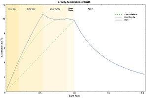

  • #46
D H said:
Lighter? Yes. Considerably lighter? No. The effect is *tiny*. Let's say your father's friend had to carry 50 pounds of equipment. Going 1/2 mile (~800m) underground would make that equipment feel about 1/10 of an ounce lighter.
Well, nuts! I made a sign error there.
The material weighs more underground, assuming typical surface rock. The effect is negligible at a depth of 800 meters.
K^2 said:
Keep in mind that this increase doesn't last for very long. It does start to drop after some depth, and goes to zero at the center.
Yes and no. It does go to zero at the center, but the graph of gravitational acceleration inside the Earth is a bit strange. Gravitational acceleration increases with depth down to 500 km or so. Gravitation then decreases down to a depth of 1600 km or so, where it starts increasing again. It continues to increase down to 2900 km or so below the surface, where g reaches it global maximum of about 10.48 m/s2.
The peaks at about 500 km and 2900 km are due to physical transitions inside the Earth. The core-mantle boundary at 2900 km represents a huge change in density. A less abrupt transition occurs within the transition zone between the lower and upper mantle. The rock of the upper mantle start to become unstable at about 400 km below the surface and progressively transition to ever denser forms with increasing depth. On the other hand there is nothing particularly special about the 1600 km depth where the local minimum occurs.
Gravitational acceleration increases with depth (decreases with height) if the local density is less than 2/3 of the average density of all of the stuff at and below the point in question but decreases with depth (increases with height) if the local density is more than 2/3 the average density. It is this average versus local density that accounts for the peaks at about 500 km and 2900 km and the local minimum at about 1600 km.

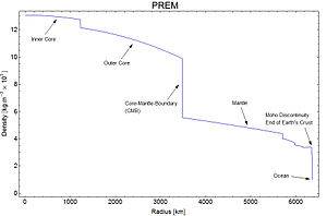

  • #69
Just a note, this thread is mostly 6 months old. Not that it isn't worth continuing the discussion.
A derivation of the "2/3 density" result D H mentioned is in Post #6 of this other recent thread:
https://www.physicsforums.com/showthread.php?t=463706
Also, a plot of g vs. depth (and altitude)
Subductionzon said:
And the accompanying image of density as you go down to the center:
Note: horizontal scales are different for the two plots!
Full-sized image of g-vs-depth plot: http://upload.wikimedia.org/wikipedia/commons/8/86/EarthGravityPREM.jpg
