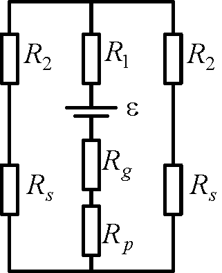

I've never done a problem like this before. I've looked for information and example problems to help me do it in my book and online, but I haven't found anything that can help me. The part about it that really confuses me is the use of the plunger. Does it move? If it does, how do I know what the length of the gap is? If it doesn't, do I just ignore the part of the plunger that is below the rest of the circuit because it acts like an open circuit (I don't know if that's true or not)? I was hoping someone here could help me figure out what to do. Thanks.

The equivalent electric scheme for your task is attached.
The MMF is
[tex]
\varepsilon = IN
[/tex]
The magnetic resistances are
[tex]
R_1 = \frac{h - l_p - l_g}{\mu_c w^2};
[/tex]
[tex]
R_2 = \frac{2h - l_s}{\mu_c w^2};
[/tex]
[tex]
R_s = \frac{l_s}{\mu_0 w^2};
[/tex]
[tex]
R_p = \frac{l_p}{\mu_p w^2};
[/tex]
[tex]
R_g = \frac{l_g}{\mu_0 w^2}.
[/tex]
The total magnetic resistance is calculated like the corresponding electrical resistance:
[tex]
R = R_1 + \frac{R_2 + R_s}{2} + R_p + R_g.
[/tex]
Then the magnetic flux is
[tex]
\Phi = \frac{\varepsilon}{R}.
[/tex]
[tex] l_p[/tex] is the length of the upper part of the plunger. So there is no problem.
do I just ignore the part of the plunger that is below the rest of the circuit?
yes
