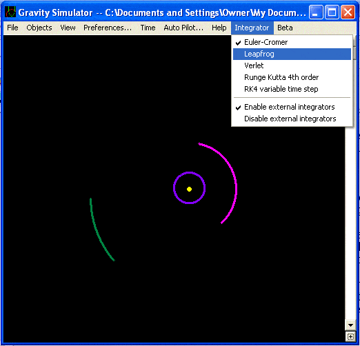

If you want to learn to walk before you learn to run, I'd start with Euler's method. It's the method DaveC described in post 3. It will give a very intiutive understanding of what you're doing. Leapfrog and RK4 are fine, but more difficult to code. At this point high accuracy is not an issure. You're creating a single planet moving around a stationary star, just to get a feel as to how to do it. So who cares if your simulation isn't accurate enough to predict solar eclipses decades into the future?
Actually Euler's method can be accurate enough to predict solar elipses decades into the future if you take a small enough time step. (delta t). The higher order integrators allow you to achieve good accuracy at larger timesteps, meaning it will take your computer less time to simulate your system decades into the future.
Later, you can upgrade to a higher order integrator. Since an Euler step is performed in the RK4 method, you'll be building upon what you've already done.

The code for these integrators is available on my website ( www.gravitysimulator.com ). If you have a Windows computer, you can download it and compare the different routines to see their strengths and weaknesses.
Your program looks great and also it runs under Linux with Wine even though i couldn't find the Integrator menu that you have shown on the picture. Also I couldn't find any source code on your website. I personally prefer open source systems and also my program when it is finished one day will be released as open source.

Sorry, I forgot to mention that the Integrator menu exists on the latest Beta version which is available here :
http://www.orbitsimulator.com/cgi-bin/yabb/YaBB.pl?num=1176774875/47#47
RK4 source code is here:
http://www.orbitsimulator.com/cgi-bin/yabb/YaBB.pl?num=1176774875/30
Euler-Cromer is here:
http://www.orbitsimulator.com/cgi-bin/yabb/YaBB.pl?num=1160874415/6#6
I can't find Verlet or Leapfrog posted, so I'll find them and post them soon on my website's forum.
Most of Gravity Simulator's math code is posted on the forum. Anybody who does any research with it is going to want to know what it's doing. Anybody who wants to write their own 'calculation engine' can do so, compile it into a .dll file and drop it into Gravity Simulator. So in that way its kind of open source. The vast majority of the unpublished code is just simple math (how to compute a diameter from a radius, etc), and instructions for how to make Graphic User Interfaces (GUIs).
Edit: I just posted Verlet and Leapfrog here: http://www.orbitsimulator.com/cgi-bin/yabb/YaBB.pl?num=1306976185/0

@tony873004
It is a really cool project you are doing, and your calculation engines looks very interesting. Did you know that with wxWidgets then it is possible rather easily to write a program with a 'killer' GUI that can compile and run very fast on (almost) all operating systems!
You can check it out here:
