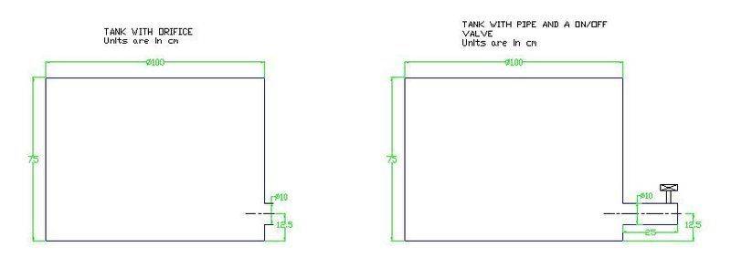

Hello guys I am glad that I got so many good responses. I was out of town for a week on a official tour. Saw all your replies only today .
After reading the replies I got another question in my mind which I have expressed as a picture.
Consider a tank of diameter 100cm and head of water column is 75cm. The tank is fitted with a short pipe of diameter 10cm and length 25cm and is fitted with a open/close valve at its free end.
Now will the water flow velocity from the pipe be same,for various positions of the valve, by considering this to be analogues to the flow from the orifice.

Well coming back to my previous post, in reality as the valve is opened more the water strikes the ground farther away from the pipe which only means that velocity is increasing as the flow area is increasing.
This looks different from what happens in a nozzle where the velocity increase as the area decreases.
How this happens?

Coming back to your question, as the valve is opened, pressure drop(head loss actually) across it reduces, effective head increases, & hence veloctiy increases.
Heff = Htotal - hloss
In case of nozzle you are talking about the velocity increase at the minimum cross section, in case of valve, you are talking about the flow downstream.
Ever heard of pressure recovery??

Hi mkkeyan,
Welcome to the board.
Fred Garvin has provided a derivation of Bernoulli's equation that indicates a correlation between d and D. Note also, stewartcs has provided essentially the same equation. Both relate V2 to a function of 1/(1-(d/D)4)
So what does that really look like in practical terms? Let's take a look...
If d is 38% the diameter of D or smaller, the increase in velocity V2 is only 1% or less. In other words, when d is small relative to D, there is no significant increase in velocity V2. It's only when d grows to be about 64% of D that the velocity can increase by 10%. Generally, when we talk about an 'orifice', we often (not always) neglect the increase in velocity due to the geometry simply because d is generally small in relation to D. For orifice flow meters however, where d is typically large and accuracy is of paramount importance, this factor that Fred is referring to, (d/D)4, is important and is always taken into account.
How this happens?
Let's neglect the slight increase in velocity due to the increase in valve opening. It's very small, and isn't needed to explain the phenomena you want to understand. As the valve is opened, the flow area through the valve is increased. So although velocity will remain constant, the flow area and thus the volumetric flow increases.
As flow rate increases, the velocity THROUGH THE PIPE increases. It is this increased velocity in the pipe that is causing the water to come out faster, "striking the ground farther away from the pipe".
Note also that as velocity in the pipe increases, there will be a higher resistance to flow due to 'frictional' resistance with the pipe walls. This is an irreversible pressure drop which can be calculated using the Darcy Weisbach equation. In fact, the DW equation is typically added into the Bernoulli equation to give overall pressure losses for a piping system. Check my post (#3) on https://www.physicsforums.com/showthread.php?t=271285" for a link to some reference material concerning pipe pressure losses and how they are calculated.

i don't agree, this isn't what happens. First you say area increases=>flow increases, then you say flow increases=>velocity increases. That is equivalent to area increases => velocity increases. flow is incompressible & hence violates law of conservation of mass.
It is the head loss at the valve which reduces, which causes the velocity to increase.
ank_gl. You've taken it out of context. There's a (minimum) flow area through a valve which causes the restriction (ie: "head loss") that's analogous to the orifice. That flow area is typically the curtain area across the valve plug. This minimum flow area is what mkkeyan is asking about when asking why flow velocity through a pipe should increase as this curtain area (and analogous orifice area) increases. So why should increasing the curtain valve flow area (which decreases head loss through the valve) result in increased velocity through the pipe? Answer: because there's more flow! Hope that clears it up for you.
:confused: no it doesn't.
More flow is due to both increase in velocity & area. Increased velocity isn't because of more flow.
Maybe we are both putting the same thing in different way:wink:
If you increase the velocity for the same given area, the flow rate will increase. Conversely, if you increase the flow rate for the same given area, the velocity will increase. Assuming incompressible fluid:
Q = Av
By increasing the orifice area, the flow rate will increase. That is to say that the orifice can flow more fluid through it since there is more area for the fluid to pass through. This increase in orifice area will also result in an increased velocity at the outlet of the orifice per the equation I posted earlier (which takes into account the conservation of mass). Take a look at this attachment, I ran some hand calcs to show how the increase in orifice area results in an increased outlet velocity and hence an increased flow rate.
Also note from the plot that if the orifice area is small enough (<10% of the size of the tank) the velocity is essentially constant. Which is why it is normally neglected.
Hope this helps.

It's not worng.
It is shown that, given a small range in varying size, we can neglect the changein velocity in the valve (even though "technically" the change in orifice size does enter the equation). However, just because the velocity is staying the same, the valve will pass more flow as the area increases.
[tex]Q = A V[/tex]
IN THE VALVE: Hold V constant. As the valve opens, V stays constant, A increases therefore Q increases.
IN THE PIPE: Hold A constant. As the valve opens and increases Q, then V has to increase due to a fixed A.
