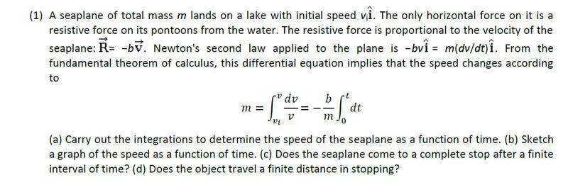

I'm lost on where to start with this. The object has an intial velocity in the X direction and has the resistive force of the plontons acting upon it when it lands. What exactly is the equation located in the problem?

That's good ol' Newton's second law, F = ma
F = -bv, ma = mdv/dt, so mdv/dt = bv, so dv/v = -b/m dt :wink:

Okay, so i follow you somewhat. F = -bv (general formula for resistive force).
According to Newton's second law, F=ma which can be rewritten as F=m(dv/dt).
You then equate those two, and you get m(dv/dt)=-bv.
What happens after this? (dv/v) is the derivative of velocity with respect to velocity? :eek:

ah, no …
∫ dv/v is a short way of writing ∫ (1/v) dv …
just integrate it! :smile:
Ohh so when you integrate that you get ln(v)?

yes! :smile:
(to be precise, ln(v) - ln(vo))
