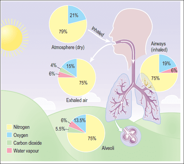

The air in your lungs is roughly at force equilibrium with the air outside your body. So their total pressures have to be equal. But, in your lungs, water vapor has evaporated into the air, and comes to vapor-liquid equilibrium with the liquid water in your body at its equilibrium vapor pressure (at your body temperature). So in your lungs, the partial pressures of oxygen and nitrogen have to less than in the outside air in order to maintain the same total pressure. The way this happens is that, when you breathe in, you take in less dry air than is necessary to fill your lungs, and the water vapor makes up the difference. When the gases mix in your lungs (before you exhale), the partial pressures of oxygen and nitrogen become less than that of the dry air that you breathed in.
If somehow you increased your body temperature to 100C (ouch), and you could remain alive when this happens, then the liquid water in your body would be boiling and releasing water vapor at 1 atm into your lungs. There would be no oxygen or nitrogen, and you couldn't even breathe any in.

If I get it, the atmosphere in the lung would be 1atm like it is outside the lung, so the water vapor pressure simply insinuates itself into the equation without increasing pressure, so whatever pressure it takes up, the rest of the gases will have a smaller share.

As far as oxygen is concerned, coming into your lungs, it is going to have a mole fraction of ~0.21, but in the gas you exhale, the mole fraction is going to be <0.21, because of the oxygen that has been used by your body. There will also be more CO2 in what you exhale.
Chet
from the book "Arterial blood gases made easy" 2ED
