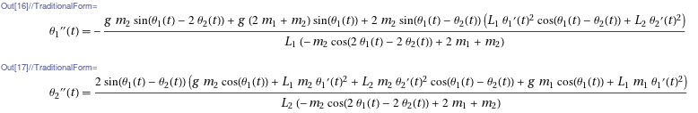

Following this guide below, I am trying to find two 2. order differential equations, one for q1'' and one for q2'', describing the movement of the double pendulum. I have no problems with the mathematics, but when the guide tells me to use Mathematica, I have some problems in getting the same result as in the guide and elsewhere.
Could you help me?
I'm attatching my recent try in mathematica.
Note: I'm not trying to numerically solve the differential equations, as done later in the mentioned guide, I'm just trying to "create" those differential equations.

So, as the guide says, you need their equations 1-4 and 13,16
Code:
eq1 = x1''[t] == -q1'[t]^2 L1 Sin[q1[t]] + q1''[t] L1 Cos[q1[t]];
eq2 = y1''[t] == q1'[t]^2 L1 Cos[q1[t]] + q1''[t] L1 Sin[q1[t]];
eq3 = x2''[t] ==  x1''[t] - q2'[t]^2 L2 Sin[q2[t]] + q2''[t] L2 Cos[q2[t]];
eq4 = y2''[t] == y1''[t] + q2'[t]^2 L2 Cos[q2[t]] + q2''[t] L2 Sin[q2[t]];
eq13 = Sin[q1[t]] (m1 y1''[t] + m2 y2''[t] + m2 g + m1 g) == -Cos[q1[t]] (m1 x1''[t] + m2 x2''[t]);
eq16 = Sin[q2[t]] (m2 y2''[t] + m2 g) == -Cos[q2[t]] (m2 x2''[t]);
Then, I think the easiest way to solve the system is to use substitute equations 1 to 4 into equations 13 and 16, then solve the result.
Code:
eq13 && eq16 //. ToRules[eq1 && eq2 && eq3 && eq4] // Factor;
soln = Solve[%, {q1''[t], q2''[t]}];
The solutions require a bit of cleaning. I found it easiest to reproduce the results in the guide by dealing with the numerator and denominator separately. The following code reproduces their results exactly.
Code:
q1''[t] /. soln[[1]] // Together[#, Trig -> True] &;
q1num = Collect[FullSimplify[Numerator[%]], {Sin[_]}, Factor]
q1den =Factor[Denominator[%%]]
q2''[t] /. soln[[1]] // Together[#, Trig -> True] &;
q2num = Collect[FullSimplify[Numerator[%]], {Sin[_]}, Factor]
q2den = Factor[Denominator[%%]]
I wrote a very quick and dirty bit of helper code to turn the variables used above that are nice in forums into ones that look nice (e.g., m1 -> m1)
Code:
symRep[expr_] := expr //. s_Symbol?(StringMatchQ[SymbolName[#],
       WordCharacter ~~ DigitCharacter] &) :> (
      Subscript[Symbol[#1 /. "q" -> "\[Theta]"], #2] & @@ Characters[SymbolName[s]])
Using it and TraditionalForm to display the above results gives
Code:
q1''[t] == q1num/q1den // symRep // TraditionalForm
q2''[t] == q2num/q2den // symRep // TraditionalForm
Note, you also might want to look at
http://demonstrations.wolfram.com/DoublePendulum/
as well as the derivation of the differential equations using the Euler-Lagrange equations
http://scienceworld.wolfram.com/physics/DoublePendulum.html
http://en.wikipedia.org/wiki/Double_pendulum#Lagrangian

I didn't look at your code before, but I have now.
You actually got quite close! Your main error was using sin and cos instead of Sin and Cos.
In standard input and output, all built-in functions start with a capital letter.
(You might want to work through the "getting started" tutorial http://reference.wolfram.com/mathematica/tutorial/IntroductionOverview.html)
So your mistake prevented Mma from using any trig identities in the simplification.
I've attached a version of your notebook with the minimal correction.
  • double pendulum tried solution.nb
