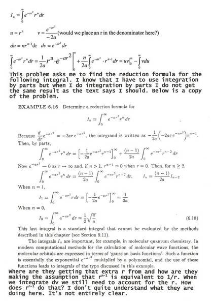

The problem asks me to: Determine a reduction formula for the stated integral (See Picture and problem at:
http://garciarussellchem.angelfire.com/Photo/
Please help me out with this problem. I don't understand why they do not include an extra r in the denominator when integrating dv. I also don't understand what purpose the r^(n-1) serves.

They are using [tex]u = r^{n-1}[/tex] and [tex]dv = re^{-ar^2}dr[/tex] then doing integration by parts with those...
This means that v must equal"
v= (re^-(ar^2))/-2ar in order for us to get the dv back right?

If you differentiate [tex]\frac{-1}{2a}e^{-ar^2}[/tex] you get [tex]re^{-ar^2}[/tex], so that's why [tex]v = \frac{-1}{2a}e^{-ar^2}[/tex]
