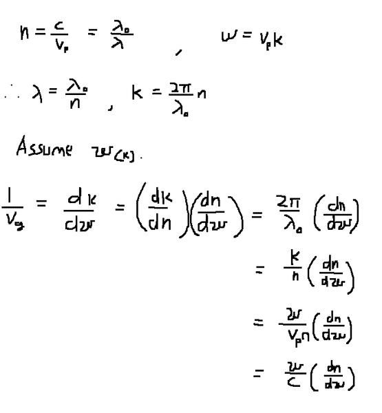

Is my initial assumption wrong?
No, it's right.
rude man said:
No, it's right.
But I seem to be missing out on a 1/vph term..
You asked if you initial assumption was right. I did not check all your work. Will try later.
You wrote dk/dw = (2pi/0)dn/dw.
However, k depends on more than w:
dk = ∂k/∂w dw + ∂k/∂n dn
So 1/vg = dk/dw = ∂k/∂w + ∂k/∂n dn/dw
= n/c + (w/c) dn/dw
Etc.
