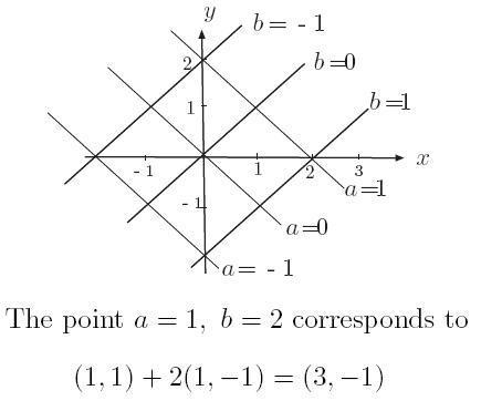

In the xy-plane, sketch the coordinate system [ a; b] corresponding to the basis
{ (1, 1 ) , (1, -1) } by drawing the lines a = 0, [tex]\pm[/tex]1 and b = 0, [tex]\pm[/tex]1. What point in the xy-plan corresponds to a = 1, b = 2?

Had a look at the answer provided, and it looked like the attached provided. Tried to make heads and tails of it but doesn't really make much sense to me..

x(1,0)+y(0,1)=a(1,1)+b(1,-1)
a=1, b=2
1(1,1)+2(1,-1) = (1+2, 1-2)= (3,-1) = x(1,0)+ y(0,1)
we can easily see x will be the first part of the vector (3,-1) and y will be the second part, so the (x,y) = (3,-1)

ahh, I see. thanks...that part of the question does make sense now.
But I'm still unsure of the drawing of the lines...If you have a look at the lines that are drawn in the answer, how did they come to that? I'm thinking of the basis that was given, but from where I stand, it only explains the lines that kinda go y = [tex]\pm[/tex] x since B = { (1,1), (-1,1) }.
Unless of course, my thinking is not correct.
