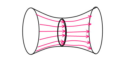

The red lines in the diagram below are electric field lines threading a wormhole - it's a 2d wormhole, as that's the only sort I can draw.
The electric field lines on the diagram are red. The wormhole geometry is sketched in black.
Electric field lines point in the direction of the electric field. The magnitude of the force is given by the density of the lines - double the lines per inch is twice the force.
Note that field lines threading the wormhole are the only way to have a potential difference when traveling down the wormhole. With no field lines, there is no electric force.
Remember Gauss's law. The integral of the normal electric field over a surface is equal to the enclosed charge.
Let's look at and end view of the left wormhole mouth.
Applying Gauss's law, we can see that the circle must enclose a negative charge.
Gravity isn't a simple two-form like the electromagnetic case. But if you have a static wormhole, the Komar mass is a conserved quantity, like the charge is, expressible as a surface integral (or as a volume integral) so you can use the same argument, as long as everything is static (or at least stationary).
