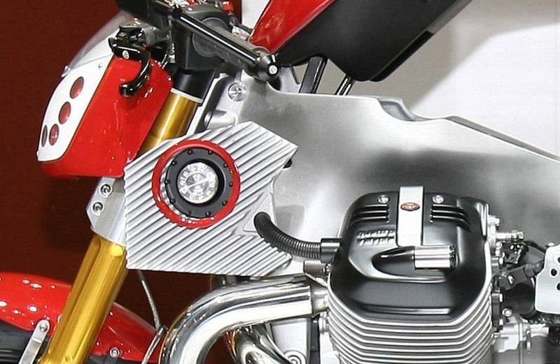

Have a look at this pic, the debate is if this heat pipe technology is being used on this concept motorcycle at all, I'd like to think yes - I'd love to hear from anyone who could either argue for or against it
Apologies for the size of the images but I can't seem to edit the size anywhere. What you see on both bikes are what appear to be heat sinks connected to the cylinder heads via a tube which I assume is a heat pipe. ?

I really can't say without taking the thing apart. Truth be told, that looks more like an electrical conduit to me.
It doesn't look like a heat pipe to me, nor does it seem to be attached to a radiator. Like Danger mentioned it looks more like an electrical conduit, perhaps holding the spark plug wire.
If that is a heat pipe (and I don't think it is), its a poorly designed one. Heat pipes, unlike heat sinks or cooling fins, do not conduct heat. Instead, they transport it using using a working fluid. When this fluid condenses at the condenser of the pipe, it must return to the evaporator via itself generator capillary pressure. Because of this, heat pipes can only be made in small lengths while still being effective. This makes them a good choice cooling things like microprocessors but bad for cooling larger things like engines.
The only exception to this is oscillating heat pipes which contain no porous material and work by the oscillation of the working fluid alone. However, these can only be made using micro-sized tubes and aren't very applicable to engines either.
Yes that is a heatpipe.
Here's a slightly longer explanation:
http://www.ashonbikes.com/content/moto-guzzi-concept-heat-pipes"
