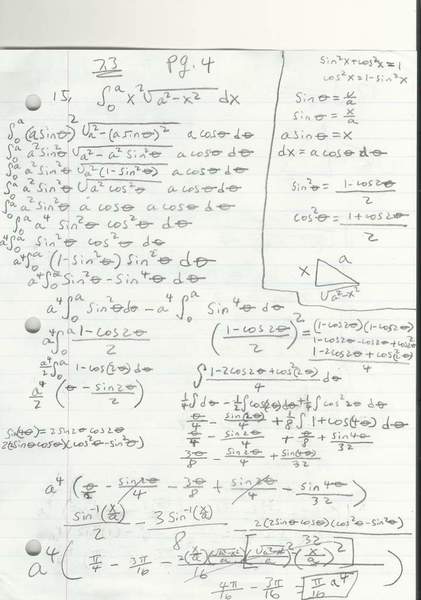

∫x^2(a^2-x^2)^.5 limits from 0 to a
It's way to much for me to type in the short amount of time I have so I included a picture of my work. It's neat and easy to read.
the answer should be (PI/16)*a^4
To tell you the truth, I didn't read the whole thing. But I suggest where you have$$
a^4\int_0^a \sin^2\theta \cos^2\theta~d\theta$$you write that as$$
a^4\int_0^a \left(\frac {\sin(2\theta}{2}\right )^2~d\theta$$and immediately use the double angle formula for the ##\sin^2(2\theta)##. It will be much easier.

Which Identity did you use to get that?
##\sin(2\theta)=2\sin\theta\cos\theta##
You did not change the limits when you did the substitution.
$$a^4\int_0^{\pi/2}\sin^2\theta \cos^2\theta\,d\theta=\frac{a^4}{4}\int_0^{\pi/2} \sin^2(2\theta)\,d\theta$$

Why does my a become PI/2?
##x=\sin\theta##, at ##x=a##, ##a=a\sin\theta \Rightarrow \theta=\pi/2##.

I understand that. The problem is when I apply it, it just gives me my original integral.
I don't see how that matters. a/a = 1 and the arcsin(1) = PI/2
It's the same.
I know it's a lot to read but can someone please look over my entire work? I am very close to the answer except for the numerator.

Apparently you don't understand it. Use$$
\sin^2(2\theta) = \frac {1-\cos(4\theta)}2$$And, as another poster has noticed and I missed, the upper limit for ##\theta## should be ##\frac \pi 2##.

So, are you going to try it? It's only one simple step left to integrate to the correct answer.

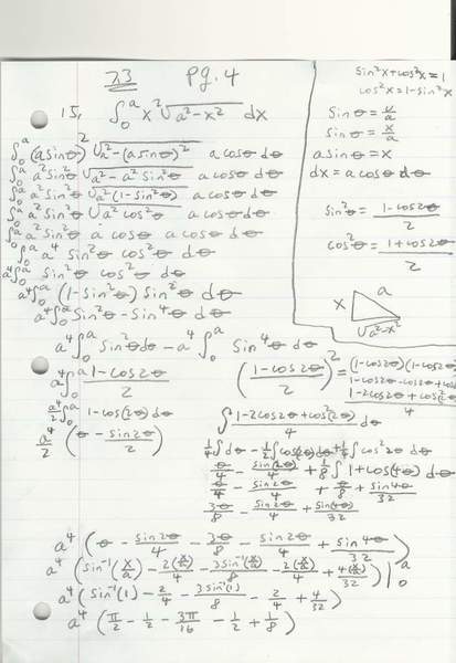

I did get the answer. I went to sleep last night, where I'm located it was past midnight. I solved it this morning.
I didn't quite do it the way you guys have suggested.
You should try it. Much simpler and you might learn something useful.
