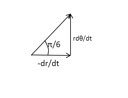

Tanya Sharma said:
No . How did you get that ?
I am not sure about how should I explain it. I attached a figure, does it help?
Maybe, look at it this way:
$$\tan\frac{\pi}{6}=\frac{r\dot{\theta}}{-\dot{r}}$$
A differential equation in ?
The one you want. From two equations, you can find a differential equation in either ##r## and ##t## or ##\theta## and ##t##.
Sorry...I still do not understand why this relation holds .I understand the angle you are talking about but why the tangent of that angle is equal to the ratio of tangential and radial components of velocity.
I think that gives a DE in r and θ ? How do you get DE in r and t ?
I have attached one more picture, I wonder if it is going to help.
You can do it another way too. Assume that the first mass is at ##\vec{r_1}##, the second one at ##\vec{r_2}## and the third one at ##\vec{r_3}##. You can write these three vectors in the following way:
$$\vec{r_1}=r\cos\theta \hat{i}+r\sin\theta \hat{j}$$
$$\vec{r_2}=r\cos\left(\theta+\frac{2\pi}{3}\right)\hat{i}+r\sin\left( \theta+\frac{2\pi}{3}\right)\hat{j}$$
$$\vec{r_3}=r\cos\left(\theta+\frac{4\pi}{3}\right)\hat{i}+r\sin\left( \theta+\frac{4\pi}{3}\right)\hat{j}$$
Do you see that the following relation holds?
$$\left(\vec{r_2}-\vec{r_1}\right)\times \frac{d\vec{r_1}}{dt}=0$$
If so, can you use the above to find some useful info?
Remember, we are working in a coordinate system where the centroid of the triangle formed by the initial position of masses is at origin.
From the relation above, you get
$$r\dot{\theta}=-\frac{\dot{r}}{\sqrt{3}}$$
Plug this in
$$u^2=\dot{r}^2+(r\dot{\theta})^2 \Rightarrow 3u^2=4\dot{r}^2$$
