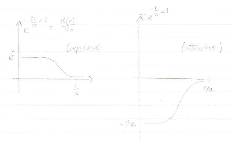

Consider the interatomic potential between 2 atoms: $$U(r) = U_o \left[exp\left(\frac{-2(r-a)}{a}\right) - 2exp \left(\frac{-(r-a)}{a} \right) \right],$$ where r is the separation between the two atoms and ##U_o## and a are constants.
1)Evaluate the expressions in the square brackets for a number of values of r/a and thereby make a plot of U(r)/Uo versus r/a, plotting the two exp terms separately.
2)Sketch the total result on the same diagram.
I have attached two graphs of the attractive and repulsive component of this potential. Conveniently, the potential can be expressed in the form y =y(x), with y = U/Uo and x =r/a. I don't know what a is so I am struggling to see if my graphs make any physical sense. As r/a decreases, however, I note that the repulsive term increases with limit of e2 in the repulsive case and -2e in the attractive case. To obtain these graphs, I simply plotted the two exp terms against r/a separetely, for random values of r/a. Can someone check these graphs?

Letting x = r/a is indeed the way to handle the parameter, a .
Both terms are basic exponential graphs. They don't flatten out for small x = r/a, unlike what you show .
[itex]\displaystyle e^{-2r/a+2}=e^2\,e^{-2r/a}\ \ [/itex] and [itex]\displaystyle \ \ 2e^{-r/a+1}=(2e)\,e^{-r/a}\ .\ [/itex]
What is each term at r=a, i.e., when x = 1 ?
At what value of x, are the two terms equal in magnitude?
At r/a = x = 1, the attractive term is -2 and the repulsion term 1.
In solving for when they are equal, I get to ##e^{-2x+1} = 2e^{-x}##, which can't be solved analytically because of that 2. ( I could use Newton Raphson although I feel that is not the purpose of the problem)
What values of r/a do you suggest? Is numbers like 1,2,3.. okay?
EDIT: What I have now is two exp looking graphs. In the attractive case, I have a curve coming from ##-\infty## and tending to 0. Similarly, in the repulsive case, I have a graph starting at ##+\infty## and again decaying to zero. This looks better - thanks. How to combine them? I suppose if we are concerned only with +ve x (i.e their separation cannot be negative since this would imply one of the other particles passes the other, I draw from x ##\geq##0 i.e from y = ##-2e^2## in attractive case and y = ##e## in repulsive case, and then both tending to 0.

Does it help to note that e2-2x = (e1-x)2?
Does that suggest a way of writing the expression so that x only appears once?

U(r) = U(ax) = U0[e2-2x-2e1-x ]
e2-2x-2e1-x = (e1-x)2 - 2e1-x = (e1-x - 1)2 - 1
I thought that getting it down to one occurrence of x might make it easier to study.
