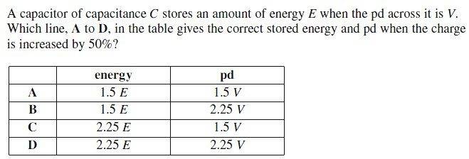

AQA Section A Q18 Jun 11
The answer should be C
E=.5QV and C=Q/V
So the original Q has increased by 1.5 times If C is constant than the voltage must also increase by 1.5 times
Now the energy E is E=.5QV V has increase by 1.5 and and so has Q which is 2.25
Infact in typing this out I think I just solved it. Is this logic and method ok

E=.5QV and C=Q/V
Seems fine to me.
Yup. You may recall that the energy stored in a capacitor is also given by:
[itex] E = \frac{1}{2}CV^2[/itex]
