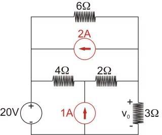

Using superposition, find [itex]v_0[/itex] in the following circuit.

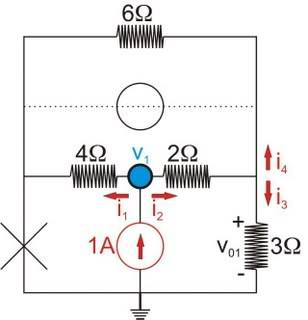

My work so far:
[tex]v_1\,=\,2\,i_2\,+\,v_{0\,1}[/tex]
[tex]v_1\,=\,4\,i_1[/tex]
[tex]v_{0\,1}\,=\,3\,i_3[/tex]
[tex]v_{0\,1}\,=\,6\,i_4[/tex]
KCL @ v1:
[tex]1\,A\,=\,i_1\,+\,i_2[/tex]
[tex]i_2\,=\,i_3\,+\,i_4[/tex]
Using these six equations, with 6 variables:
[tex]v_{0\,1}\,=\,\frac{12}{7}\,V[/tex]
Is that correct?
My real question is how to put the six equations above into matrix form to enable solving using RREF.
Thanks:tongue:
EDIT: I have fixed this part with Paallikko's guidance (thanks!)
[tex]i_1\,=\,\frac{1}{4}\,v_1[/tex]
[tex]i_2\,=\,\frac{1}{2}\,v_1\,-\,\frac{1}{2}\,v_{01}[/tex]
[tex]i_3\,=\,\frac{1}{3}\,v_{01}[/tex]
[tex]i_4\,=\,\frac{1}{6}\,v_{01}[/tex]
[tex]i_1\,+\,i_2\,=\,1\,A\,\,\,\Rightarrow\,\,\,\frac{3}{4}\,v_1\,-\,\frac{1}{2}\,v_{01}\,=\,1[/tex]
[tex]i_3\,+\,i_4\,=\,i_2\,\,\,\Rightarrow\,\,\,\frac{1}{3}\,v_{01}\,+\,\frac{1}{6}\,v_{01}\,=\,\frac{1}{2}\,v_1\,-\,\frac{1}{2}\,v_{01}[/tex]
[tex]v_{01}\,=\,1\,V[/tex]

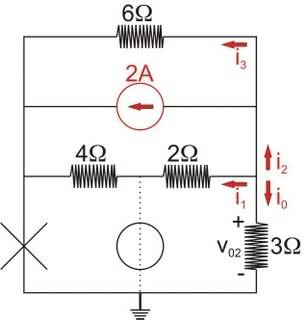

Apply superposition two:
[tex]i_3\,=\,i_2\,-\,2\,A[/tex]
[tex]i_1\,=\,i_0\,+\,i_2[/tex]
[tex]v_{0\,2}\,=\,6\,i_1\,=\,6\,i_3\,=\,3\,i_o[/tex]
From these five equations, I put into a matrix and solve.
[tex]v_{0\,2}\,=\,-6\,V[/tex]

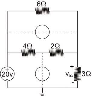

Next, I do the last superposition:

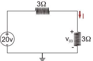

The circuit above can be simplified:
[tex]v_{0\,3}\,=\,3\,I[/tex]
[tex]v_{0\,3}\,=\,3\,\left(\frac{20\,V}{3\,\ohm}\right)\,=\,20\,V[/tex]
Total them up:
[tex]v_0\,=\,v_{0\,1}\,+\,v_{0\,2}\,+\,v_{0\,3}[/tex]
[tex]v_0\,=\,\left(\frac{12}{7}\,V\right)\,+\,(-6\,V)\,+\,(20\,V)[/tex]

Does this look right? If not, please explain the errors and how to correct them. Thanks:tongue2:
Well, you've understood how to use superposition (setting the sources to 0), you even seem to have most of the equations right*. However, all your calculations are wrong.
The first one in matrix form would be (solve for ix from the first equations and substitute into the KCL equations):
[tex]
\left[ {\begin{array}{*{20}c}
{3/4} & { - 1/2} \\
{ - 1/2} & 1 \\
\end{array} } \right]\left[ {\begin{array}{*{20}c}
{V_1} \\
{V_2} \\
\end{array} } \right] = \left[ {\begin{array}{*{20}c}
1 \\
0 \\
[/tex]
* the two equations below are wrong
[tex]i_1=i_0 + i_2[/tex]
[tex]v_{0\,3}\,=\,3\,\left(\frac{20\,V}{3\,\ohm}\right) \,=\,20\,V[/tex]PS. If you're not familiar with PSpice, there's a free version available for download eg. here: http://www.electronics-lab.com/downloads/schematic/013/ you can quickly check if your answers are correct with it.

For the first incorrect equation (in the 2nd part of problem), I see that all the currents are going out of the node. Does this mean that the actual equation is [tex]i_0\,+\,i_1\,+\,i_2\,=\,0[/tex]?
In the third part of the problem, is the error becuase I didn't include both resistors in the I = equation?
[tex]v_{03}\,=\,3\,I[/tex]
[tex]v_{03}\,=\,3\,\left(\frac{20\,V}{6\,\ohm}\right)\,=\,10\,V[/tex]
Is that right now?
Yep, they're right now.
How do I solve the second part? I keep getting 0V for [tex]v_{02}[/tex].
I also used Pspice and got an 8V differential at the resistor for [tex]v_0[/tex].
[tex]v_0\,=\,v_{01}\,+\,v_{02}\,+\,v_{03}[/tex]
[tex]v_0\,=\,1V\,+\,0V\,+\,10V\,=\,11V[/tex]
This is 3V higher than Pspice reports though.
You've written:
v02 = 3i0 = 6i1 = 6i3 (1)
i2 - i3 = 2 (2)
i0 + i1 + i2 = 0 (3)
Substituting (2) into (3) (Eliminating i2):
i0 + i1 + i3 = -2
Substituting (1) into the above:
v02(1/3 + 1/6 + 1/6) = -2
=> v02 = -3 (V)
