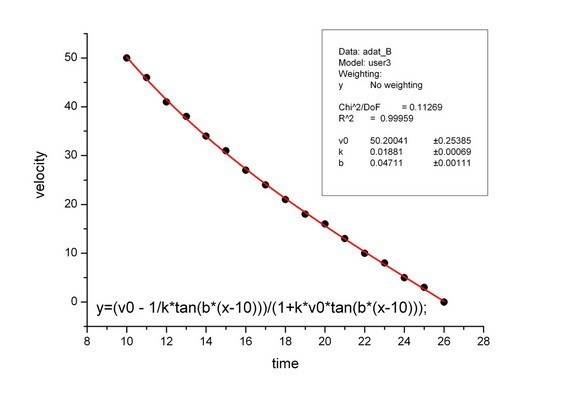

Thanks ehild. I tried to use the solution to find predictions for experimental data, but the values are extremely strange. I'm not sure if it's the way I've worked out [tex]v_0[/tex], but seemingly regardless of the value, the output jumps around really weirdly. The data I'm supposed to be modelling with the equation is:

What values did you use for mu, lambda, vo?

[tex]\mu = \frac{301687.25}{120000}[/tex]
[tex]3 \lambda = 103.02[/tex]
[tex]v_0[/tex] was set as to satisfy when t = 10, v = 50
Where did these value come from? mu is all right, but 3lambda seems too big. You know that the tangent becomes infinite at pi/2, so k*mu*t cannot be greater than that. And the solution is valid only for positive
velocities. If the tangent is too big, v becomes negative. That constant force is realistic only till the aeroplane stops.
In what units did you measure the speed and the time? Did the braking start at t=10?
I used your data and the last version of my function to get the parameters by fitting. See the attached picture. But I got vo (actually it is at t=10) 50.2, mu =2.504, 3lambda=8.86˙10-4.
ehild

Oh yes, [tex]3 \lambda[/tex] was written incorrectly, it should have been:
[tex]3 \lambda = \frac{103.02}{120000}[/tex]
Sorry about that D: The units are standard, v in ms^-1 and t in seconds. The breaking started at t=10 onwards yes.
Your attached graph is a really close fit! I'll try out your new function now with these values :)
Thanks
With this 3lambda, everything fits!
ehild
Just tried it all in excel. It gives great results :D Thank you very much ehild! Life saver :)

You are right, the breaking began at t=10, so I took it into account in my fitting function (used t=time-10 instead of the given time values in the fitting function), and it worked surprisingly well! But the fitting works with the original t values, too, only vo is much higher (147) then.

The v(t) function is in terms of the "braking time" which is the indicated time-10 s. So Vo is really V10. You can either plot the data in terms of the braking time and then vo = 50 m/s, or keep the original time values, but calculate the velocities in term of the braking time. If so, denote vo by v(10). That 147 as vo has no sense, as the velocity function was different before the braking started.
ehild
ehild
Okay, I see :) Thanks, will do!
You'd just have to mention your assumption that the braking process started at t=0 and not at t=10 sec as indicated, just so the person marking your work knows not to nitpick on that particular issue.
