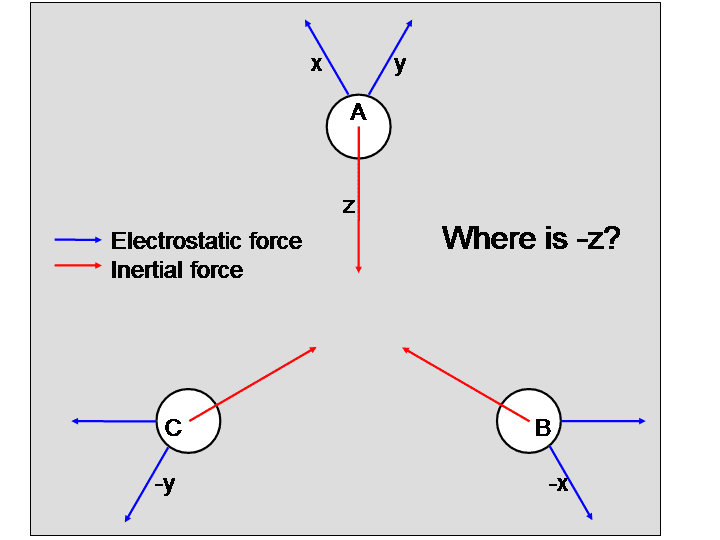

Dear all
When I first learned about forces and motion I was taught F=ma in terms of apply a force to a mass and the acceleration of that mass = x. I was quite clear about how something moved ie apply a force to a mass - it moves or tends to move.
But then I came onto the D' Alembert variation of F-ma=0 ie everything in equilibrium.
Very useful it is too.
In terms of F= ma so ma = F and F-F = 0. So the I thought well how can things move then? I was told by many that the insertion of inertia into the equation so that F-ma = 0 is just a mathematical trick and useful for resolving forces and moments in a mechanical system.
However to me at least inertia is real and easily proved. You can't apply a force unless an equivalent force pushes back.
So I decided that motion is caused by the transfer of kinetic energy of momentum in the direction of the force applied. In terms of conservation of momentum, so that even though there is equal and opposite inertial force there is not equal and opposite momentum and the motion carries on in the direction of the force.
But I can't quite resolve that concept! Since the force applied to the mass does work on the mass as it accelerates therefore (in my mind) the inertial force must do equal and opposite (negative) work to the applied force. As Ek = 1/2mv^2 and work = fd theta and this becomes W = 1/2mv^2theta then Ek of applied force should equal negative Ek of inertial force.
So how do things move??
Can anyone explain? have I got my concepts mixed up?

Ah. Now I understand your confusion.
The formula F = ma (or F = dp/dt) is, for various reasons, very subtle. First, it's important to realize that we never measure forces. There's no such thing as a 'force-o-meter'. This is not the case for acceleration (or velocity, or position)- we have rulers and stopwatches to measure these things.
There may be objections to this- surely a spring measures force? Or a strain gauge? Or a pressure gauge? None of those things really do, they rely on constitutive (material properties) relationships which relate a force (dynamic quantity) to a displacement (kinematic quantity).
F=ma conceals this important point- it sets equal a *kinematic* quantity (acceleration), with a *dynamic* quantity (force). We do not ultimately know what causes a force. We have lots of models, to be sure, in as much detail and complexity as you can stomach. But in the end, we still have no force-o-meter.
If you like, you may think of 'mass' as being a constant of proportionality between an applied force (whatever the origin of said force) and a resultant motion- but that has limits as well (massless particles). Consequently, it may be helpful to spend time temporarily expunging 'force' from your mental concepts and instead think in terms of momentum and energy.

Re-arranging the equation to f-ma=0 doesn't change anything. 0 isn't the acceleration, it is the sum of the forces.
But then you repeat your question without actually connecting it to the math you just showed, so it isn't clear what you don't like about this.
Anyway, though, by throwing energy in there in the second half of the post, you are just confusing yourself. If you ever do sort out the math of it, you'll find it just reduces back to f=ma anyway. So just drop that entire thing and just get your arms around the idea that f=ma is a true and complete statement of how a force results in acceleration.
Hmm, maybe this will help. In order to apply a force to an object and not have it move, you need two force pairs on it, not one. If you have an object bolted to the ground and you push on it, you and the object exchange a force and the object and the bolt exchange a force. The forces sum to zero, with two positive and two negative.
If you have only one force pair, one of those forces manifests itself as ma in order to maintain the balance. If you start with F1=F2 and know that there is no corresponding force pair to stop the acceleration, then F2 must be a force due to inertia and acceleration. F2=ma.
Physicists often treat gravity as equivalent to acceleration, so the same principle applies to the unmoving climber on the side of the mountan. The force pair between the climber and mountain is F1=F2 and F2 still equals ma.

Re reading this I see what you are staying (i think) So if I push against someone who is pushing back we each have Inertial forces (1 pair) and apllied forces (2 pair). Remove one of the applied force and we have motion. This means we have unbalanced forces and so one inertial force must accelerate to give us the balanced equation. Hmmm! Have I got that right. Not heard that concept before, I'll have to think about that one
Cheers all Dave
