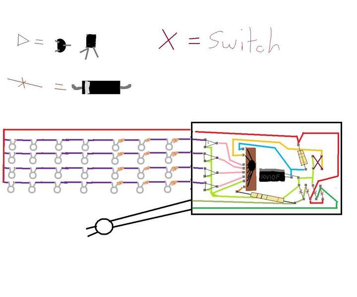

fyi in my diagragm i show 7 bulbs in series, but actually the current setup is 25, 3 have resistors, 22 do not. I did not show all the bulbs to save space.
the schematic i posted is my rendition of the actual boxes i have now, again one of these for each 100 bulb string of xmas lights. This is the factory setup, not something i made.

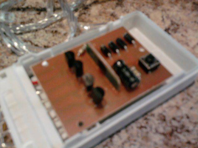

It is hard to guess what that control box is doing and even harder to suggest ways of modifying it. However you drew what looks like a large capacitor and this is possibly a timing capacitor for the flash rate.
If you cut one wire of this, (AT YOUR OWN RISK) the flashing may stop. You can solder it back afterwards.
If the flashing stops, it might stop with the lights on or off. This is speculative, though, and again at your own risk if you try it.

thank you. The fish have places they could go. Whne the lights are just "ON" they are ok. The lights have 8 functions, 1 combination, 2 in waves, 3 sequential, 4 slo glo, 5 chasing/flash, 6slow fade, 7 twinkle/flash, 8 steady on. The default is 1 combination, and some of the flash modes are fast and furious, worse then any lightning strom they might find in nature.

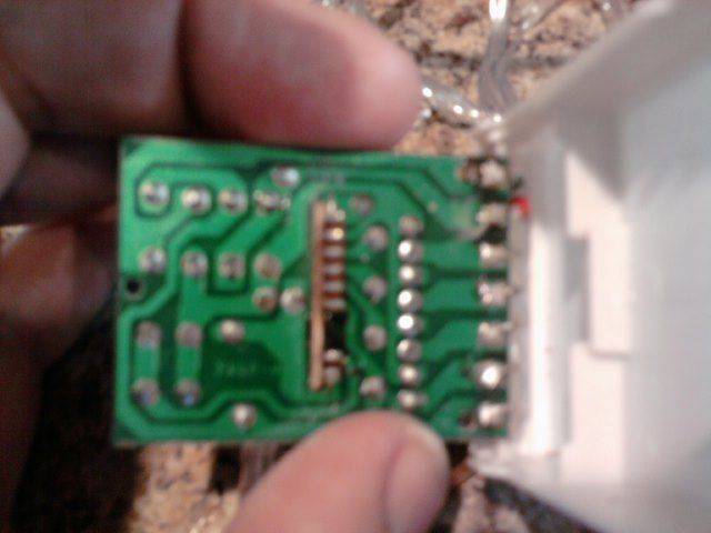

I think the "modes" come from the piece in the iddle. It looks like a little micro processor. AND it has the four outputs that goto what i think are transistors, one for each leg of 25 lights. Also, each leg of 25 lights does the same thing. So the various effects come from controlling each of the 4 legs seperatly, if that makes any sense. I do not know how to describe it. The "transistors" have 3 legs, and one of those legs goes to the micro processor. So it looks to me like that is the controlly feature.
