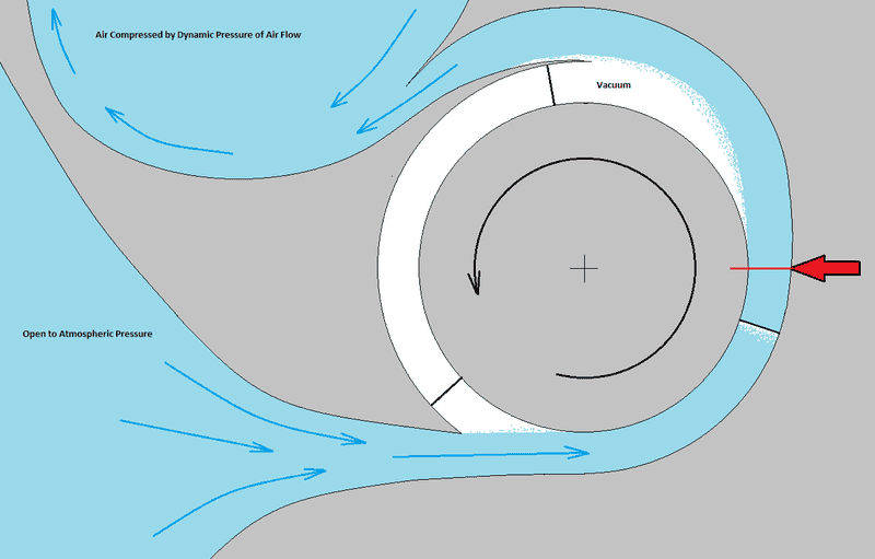

In order to give you a picture of the set up I am envisioning, I have included one. I call it a Vacuum Wheel.
According to your calculations, through a 1 sq ft hole into a vacuum, air would flow through the hole with a velocity of 646 SCFS. So, in theory anyways, I would be able to assimilate a vacuum if I expanded a container's volume at a slightly higher rate like 650 CFS. True?
Well I am trying to do something of this sort with my vacuum wheel, but instead of continuously expanding the volume of a container, I am trying to continuously re-create a vacuum using the centripetal force created by the angular acceleration of the air as it travels around the wheel.
So here is one of my next questions, given the flow rate or angular velocity of the wheel at 650 ft/sec how tight would I need to make the radius of the wheel to create enough centripetal force to create a vacuum as shown by the design?
But moving forward, according to the design of my wheel, it is my understanding that air flows are created by the pushing expansive force of the molecules under higher pressures and not caused necessarily by the so called "sucking force" of low pressure. To me this implies that velocity of the airflow up to the red arrow on the diagram is actually produced and input into the system by the atmospheric pressure force and not necessariy by the wheel itself. Up to this point the air entering the system is being pushed, not pulled. It is not until the wheel fin moves into the flow and begins pushing the flow forward that the wheel become responsible for any increases or maintenances of the velocity of the air flow.
It is also my theoretical understanding that the dynamic pressure and momentum of the air flow as it exits into high pressures will in essence "protect or hide" the fin of the wheel in the airflow from the higher than atmospheric pressure on the exiting side of the wheel which leads me to my next question.
How much power to you think that it would take to rotate the wheel with an exterior angular velocity of 650 ft/sec? (RPMs determined obviously by the radius figured by my earlier question.) Or, what pressure force do you think the air flow would exert on the forward face of the wheel fin submerged in the airflow?
This power value will obviously need to be compared then to the power which is able to be generated by the air flow, whether the this power be generated on the entry or exiting side of the wheel, I don't know if one would be more efficient than the other.
I know that in all case energy in = energy out.
But I guess that the real and final question that I have for you is this:
In this application does energy in = energy input by Earth's atmospheric pressure + energy input mechanically to rotate the wheel, or does energy in = only energy input mechanically to rotate the wheel.

The pump in your diagram is a vane pump. It is certainly theoretically possible to arrange a vane pump so that there is a pretty good vacuum at certain locations in the pump, although I don't think the flowfield would look quite like what you have drawn. The presence of a vacuum does not make the pump more efficient, though, and certainly does not reverse the flow of work into device. I'm sort of at a loss of for what else to say, because the assumptions underlying your calculations are inconsistent, and it's not clear how to "fix" your drawing so that it makes some kind of mechanical sense. For example, one might consider a centrifugal pump instead of a vane pump, since you get better single-stage pressure ratios out of a centrifugal pump. But the pump you've shown essentially takes air at atmospheric pressure, whirls it around, and exhausts to atmospheric pressure. So it really just dissipates the shaft power internally and exhausts a bunch of hot air.
Or one could rearrange the layout of the device. Imagine the device were a box that one kept at low pressure. At one end of the box, a turbine operating at 100% efficiency extracts power from air that flows through the turbine into the box. At the other end is a pump that operates at 100% efficiency that keeps the box evacuated by removing exactly the amount of air that enters by pumping it back up to atmospheric pressure and sending it back into the atmosphere. If both devices are 100% efficient, then both processes are vertical lines on a T-s diagram and the power required by the pump is exactly what is output from the turbine -- and there is no net output of work. If the devices are not 100% efficient, then the entropy increases during both the expansion and compression phases, and the process lines drift to the right on at T-s diagram. In that case the pump requires more power than the turbine will supply. The net work is into the device. These considerations are true regardless of how many stages the turbine and pump have, and how low a pressure one takes the box to.

I would still like this number from you. Assume a 4 ft outside radius, with around a 1800 rpm rotation which gives the wheel fin about a 660 ft/sec rotational velocity. Do you believe that the airflow is going to exert around a 400 lb/ft^2 counter rotational force on the wheel fin? The thing is, is that it is only the high rate of flow and momentum which creates a centrifugal force which allows the wheel in my design to move any air at all. With a slow rotation, as far as air moving through the wheel from the entry to the exit, no work will be performed at all, and I can’t reason where that much resistance to rotation would come from, but maybe you can enlighten me.
I am sorry for the confusion, but the diagram that I included only really included one part of the complete two part system. The vacuum wheel is the pump, but I did not include the turbine or method of energy generation.
I predicted that I would be able to produce about 500 hp by compressing the air on the exiting side of the wheel to about 18.5 psi of total pressure, and using a large surface area, slow rotation volume displacement turbine, the number that you came back at me with was much higher. The turbine used to do that was not shown in my diagram, and for theoretically purposed we could simplify it to the power produced when expanding a large piston. I know like to look at the two systems as complete separate.
How much power would it take to rotate the wheel at 1800 rpms?
How much power can be produced by the airflow which will naturally flow through the wheel spinning at 1800 rpms?
Maybe the two independent calculations will be exactly the same, I don’t know, but I bet that if you honestly and independently calculated the two numbers the later would be higher than the first.

Okay, let's see if I can answer some of these questions. Let's start with the misconceptions inherent in your statement above.
The first obstacle is that the vacuum wheel as you have drawn it cannot work. Consider the air flowing into the entrance. The way you have drawn it, the flow approaches a sharp corner with vacuum on one side, and then continues merrily in the direction it was flowing, ignoring the vacuum next to it, and I'm guessing you think that somehow this momentum has been "earned" and that the flow won't significantly change direction. Compressible flows absolutely do not behave like that. In a convergent passage like you have drawn, with anything less than half an atmosphere of pressure downstream, the flow will accelerate to Mach 1. When that flow exhausts into a vacuum, it expands around the corner in what is called a "Prandtl-Meyer fan". The Mach number continues to rise as the flow turns the corner. Going from M=1 to M=infinity, the flow goes from axial and turns 130 degrees, i.e. it flows back upstream into the vacuum channel.
Now, the way you have depicted the wheel working, that accelerated flow runs straight into the vane coming out of the vacuum channel. This hypersonic flow rams into the vane, and what you would see would be a complicated set of shocks, reflecting and intersecting and moving with the vane, with a subsonic layer next to the vane material and the hub, because these strong shocks would decelerate the hypersonic flow back to a subsonic condition, generating a lot of entropy in the process. It's very difficult to compute the result of this moving set of shocks and expansions.
As the vane passes by the entrance channel, the flow field gets more complicated. Part of the flow slams into the vane from behind, generating another set of compression shocks and sneaking flow upstream into the vacuum channel again. It's hard to tell, exactly, but I think it is likely the flow will reach the next vane after shocking off the outer curved walls and expanding around the inner curved walls before that vane has a chance to move appreciably. The other part of the flow expands around the vane and generates a set of expansions and shocks. Meanwhile, the curved main channel that you intended the flow to go down will also throw off a set of shocks because supersonic flow doesn't just change direction without shocking (there is one exception, for highly uniform flow at a fixed Mach number you can design a curved compression surface that will isentropically compress the flow, but this surface (a) is not circular, and (b) only works for one particular Mach number).
So for these reasons the wheel will not provide anything approaching a steady vacuum to draw flow into the device. It will stall and sputter as the flow intermittently fills the vacuum channel as the vanes pass the entrance.
That's why it's practically impossible to provide a reasonable answer to how much power the device will demand. But let's push on some of your other questions. For example you ask

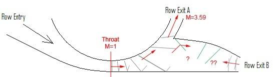

I have another question which will greatly help my understanding. I have attached a small diagram of an airflow. Assume a hypersonic airflow being pumped into the entry, with standard atmospheric pressure outside Exit B and a vacuum outside exit A, at Mach 1 what percentage of the airflow do you think would exit through exit B?
Thank you for you thoughts,
rcoopster
Well, it's a complicated ducting arrangement, but my first estimate would be based on assuming (a) the flow area at "A" is about the same as that of the throat, (b) that the flow at A is about 60 degrees offset from the flow at the throat, and (c) that the backpressure at B is not sufficient to completely decelerate the flow coming through the throat. The last assumption is most likely to be wrong, but set that aside to see what (a) and (b) tell us.
If the downstream pressure is low enough, the flow at the throat will choke, i.e will be at M=1. As the wall curves away on the left side of the flow, the air will accelerate around the corner, forming the afore-mentioned Prandtl-Meyer fan. Knowing the initial Mach number (1) and the turning angle (60 degrees) allows us to calculate the Mach number at A, which turns out to be 3.59. Now, if the flow areas are the same, the ratio of mass flows will just be the ratio of the "D" flow functions, which turns out to be 0.135. That is, just 13.5% of the flow will go down duct A. In this scenario, one is tempted to conclude that 86.5% of the flow will go out exit B. Perhaps part of it will be through an oblique shock at the corner between A and B, as indicated in the attached picture.
But not so fast! The real problem with this setup is that if the pressure upstream of the entrance and downstream of B are both equal to atmospheric pressure, then the flow through B will actually be inwards, that is, flow will enter both through "entrance" and "B" and flow out through the vacuum port A. And with the odd flow geometry between B and A, it is not clear where the flow will choke. With mass flows from both A and B, it seems likely that the actual choke point will be inside of duct A, and all the flow upstream of A will be subsonic, though both entrance and B. If that is the case, then the flow at the original throat will not be sonic, and there will be no Prandtl-Meyer fan.
So, like I said in a previous post, the flow will be whatever is necessary to match the boundary conditions, provided the boundary conditions are physically compatible.

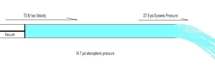

I have attached another diagram, and in the diagram I show a round piston with a 1 sq ft surface area pushing water through the pipe out into to open atmosphere at a constant velocity of 75 ft/sec. There is a vacuum behind the piston, and I have calculated a 37.9 psi dynamic pressure being generated by the flow.
My question is: Based upon the dynamic pressure generated by the flow, the atmospheric outside the pipe, and the vacuum behind the piston plate, (ignoring the viscosity of the flow and the pipe walls) what will the net acting force be on the piston plate?
Will it simply be 2116.8 lbs, which is the pressure difference between the vacuum and the outside atmospheric pressure, or does the dynamic pressure or momentum of the flow have any affect?
