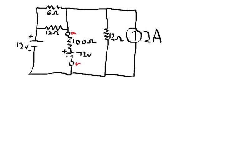

The discussion focuses on calculating the Norton equivalent circuit, specifically the Norton current. The user calculates the Norton resistance as 3 ohms and derives two Norton currents: I'_N as 1.5A and I''_N as 2A. The final Norton current, I_N, is determined to be 0.5A after subtracting I'_N from I''_N. Participants seek clarification on the rationale behind the calculation of I'_N, indicating a need for deeper understanding of the method used.
johnsy1312
Finding the Norton Equivalent circuit for the circuit attached
I attempted this solution but i am unsure if my Norton's current is correct:
R_N = \frac{1}{\frac{1}{6}+\frac{1}{12}+\frac{1}{12}}=3ohms
I'_N = \frac{12*2}{12+4}=1.5A, I''_N = 2A
I_N = 2A - 1.5A = 0.5A
Can you explain the logic behind your Norton current calculations? In particular, what motivates your calculation of ##I'_N## ?
