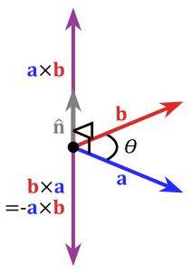

I know intuitively that the Cross Product of two vectors ##\vec{A}## and ##\vec{B}## represents another vector ##\vec{A \times B}## perpendicular to it. In study of physics we come across this situation a lot. Hence I can visualize some applications of it
But that's not all. The magnitude of the cross product also has a geometrical interpretation:

What baffles me, is that you obviously found the wiki page on the cross product (and posted the picture from it), but couldn't find the page on the dot product with the picture jtbell posted.
