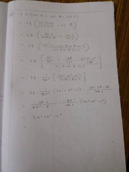

In any triangle ABC, prove that $$ a^2 + b^2 +c^2 =4 \Delta (\cot {A}+\cot {B}+\cot {C}) $$

Wrichik Basu said:
The area of Triangle, the standard notation used in Trigonometry.
##\displaystyle {c \over \sin c} = 2R##
Check your work again, you replace ##\sin c## with ##a/(2R)##, you should do ##c/(2R)##
Buffu said:
##\displaystyle {c \over \sin^2 c} = 2R##
You are wrong: $$\frac {c} {\sin (c)} = 2R$$ not $$\frac {c}{\sin ^2 (c)} = 2R$$
Yes, that was a typo. o0)o0):-p
