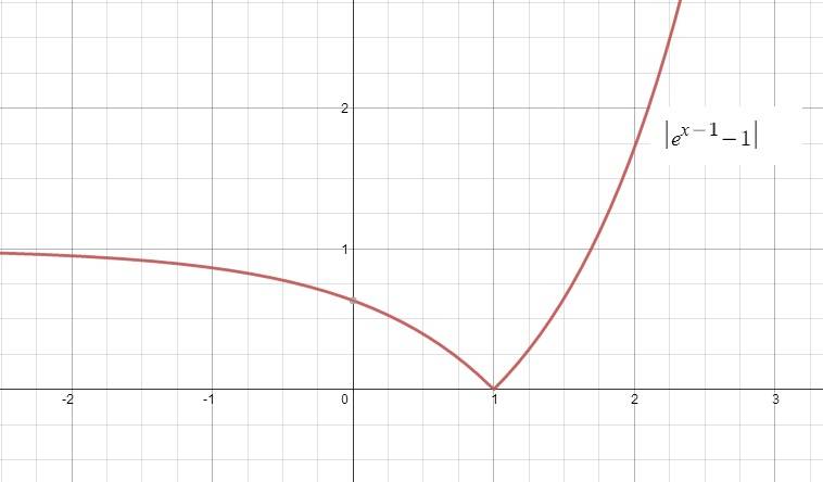

Suppose [itex]p(x)\ =\ a_0\ +\ a_1x\ +\ a_2x^2\ +\ ...\ + a_nx^n[/itex].
Now if [itex]|p(x)|\ <=\ |e^{x-1}\ -\ 1|[/itex] for all [itex]x\ >=\ 0[/itex] then
Prove [itex]|a_1\ +\ 2a_2\ +\ ...\ + na_n|\ <=\ 1[/itex].
2. Relevant Graph( [itex]|e^{x-1}\ -\ 1|[/itex] )
From the graph we can conclude that
p(x) should pass through (1,0)
=> [itex]a_1\ +\ a_2\ +\ ...\ + a_n\ =\ 0[/itex]
Further, I'm not able to apply any other condition given to simplify the expression. Their is of course something to do with the derivative as I found this question in a book of differentiation.
Any help would be highly appreciated.
Thanks
wrong. note that p passing through (1,0) means that [itex]p(1)=a_0+a_1+\cdots +a_n=0\Rightarrow a_0=-(a_1+\cdots +a_n)[/itex]

If I could just prove that the inequality of the funciton
i.e. [itex]|p(x)|\ <=\ |e^{x-1}\ −\ 1|[/itex]
also holds true for the derivative
i.e. [itex](|p(x)|)'\ <=\ (|e^{x-1}\ −\ 1|)'[/itex]
then I could just substitute x = 1 and prove the question.
But I just couldn't formulate how to deduce from the given conditions to that part.
Any Ideas ?
As you noted, p(1) = 0, so you can say that
$$\lvert p(x) - p(1) \rvert \le \lvert e^{x-1}-1 \rvert.$$ Now consider the definition of a derivative as a limit of a difference quotient and write down the expression for p'(1). Do you see the connection now?
Likes 1 person
Right.
[tex]p'(1)\ =\ lim_{h\rightarrow0}\frac{p(1+h)-p(1)}{h}\\
\implies a_1+2a_2+3a_3+...+na_n\ =\ lim_{h\rightarrow0}\frac{p(1+h)}{h},\ as\ p(1)\ =\ 0
[/tex]
I was able to solve it.
Thank you for your time
