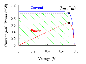

nashsth said:
For the TL;DR version, skip to the last two paragraphs.
I'm no expert in solar cells, but I do know that it's important to operate the solar cells at their Maximum Power Point. As shown in your first link, that will be when there is almost a forward bias on the cell, but not quite. If you let it go too close to forward conduction, you lose power. The "bias" is not really a bias, it is just a voltage that is caused by the photocurrent creating a voltage drop across the power converter circuit (a resistor or a switching power supply input).
https://ecee.colorado.edu/~bart/book/solar.gif
https://ecee.colorado.edu/~bart/book/solar1.gif
To study the properties of your system you might want to apply a bias, but means that you have to supply it.
The idea of a solar cell in real operation is to obtain energy from it, not supply to it. So there you generally don't want to have to apply a bias.
+1
Typically you bias a photo diode but not a solar cell. For the reason ngonyama and berkeman state.
Photo diodes are typically used to detect a light signal and turn it into a voltage signal. Biasing moves the operating point to where the light vs voltage curve is steeper. That makes it more sensitive. The photo diode consumes power from the bias network.
You don't bias a solar cell in the same way but you may want to control the load on it for the reason berkeman gives. In AC circuits transformers are used to "match" a load to a supply (example 12V load to 110V supply). Solar panels are DC and their voltage and current varies with both load and illumination. So a more complicated matching device is needed.
In something like a solar powered calculator it might not be essential to capture every last bit of power so you could just use a linear regulator or even a resistor to match the output of the solar cell to the battery and waste any excess power as heat. In other applications it's more important and you use a controller that behaves a bit like a transformer but for DC and with variable turns ratio. It automatically adjusts itself to keep the output of the panels at the max possible power point for the amount of light currently arriving.
