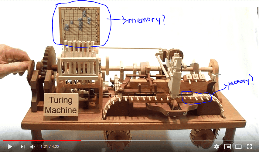

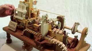

The simplest computer is a Turing machine and there is an excellent working model in LEGO on YouTube if you search for it. Watch how it reads ops from it’s tape and then modifies it’s tape. The tape is the memory and the machinery around it is the cpu.

Thank you so much for pointing me to the Turing Machine, I was trying to find something in between the Abacus and the super-complex thing that I'm typing this on!
I'm looking into where I can buy own kit w/ the LEGO's to build one right now.

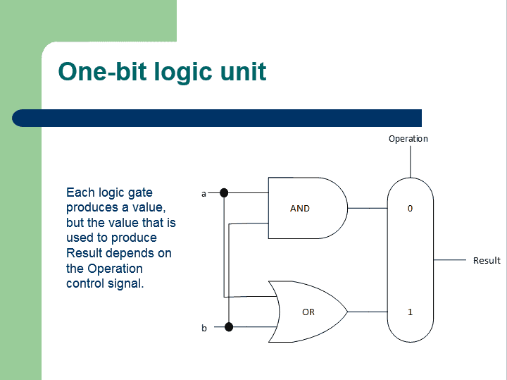

Here's a figure that represents the logic gates that might be involved in ANDing two bits.
240986
The two bits come in on the lines marked a and b. A signal comes in on the line marked Operation, that controls which of the two operations to perform -- an AND of the two bits or an OR of the two bits. If the Operation signal is AND, and both bits are 1, the result is 1. If either or both bits are 0, the Result is 0. The figure also consists of logic gates to perform the OR of two bits.
A CPU consists of a large number of logic gates and controller hardware.

Hence, my initial interest in models which do not even involve electricity.
